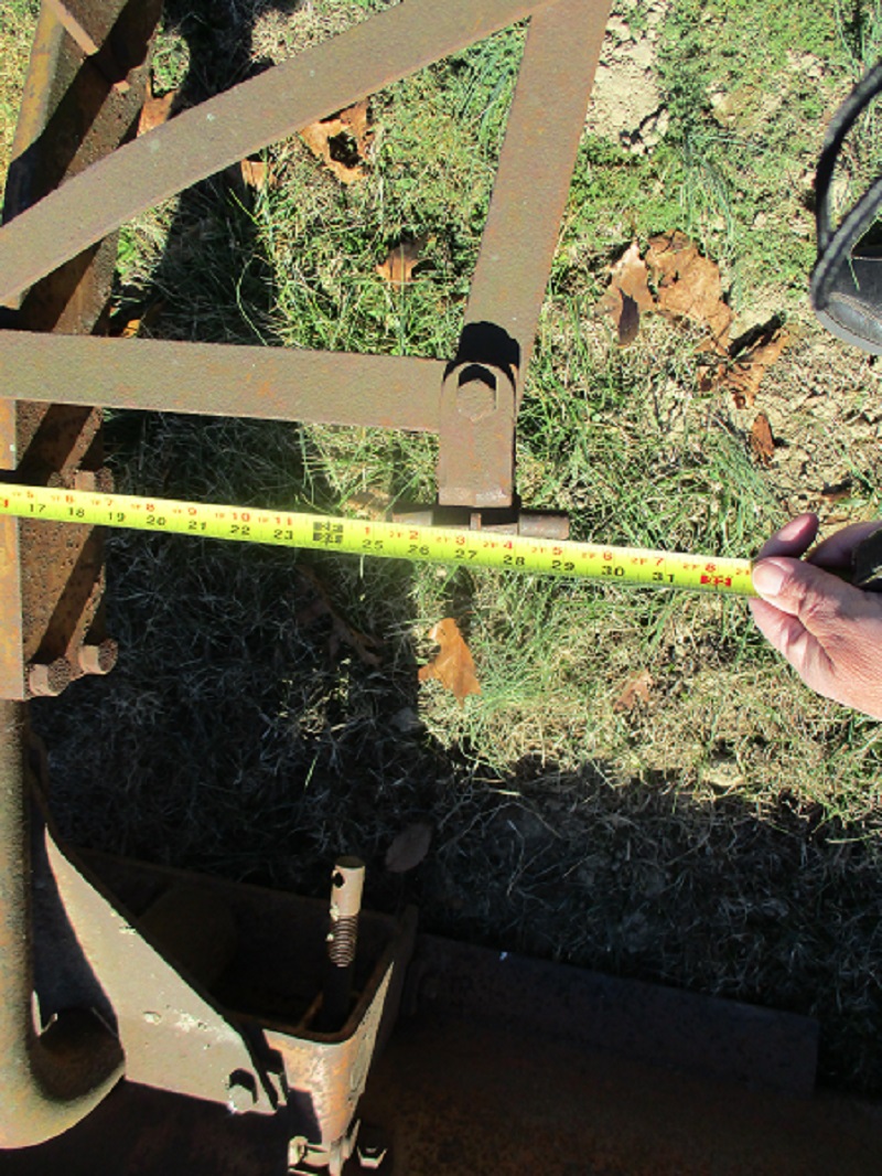

This is a picture of a blade that came with a CA.  The distance between the snap coupler hooks is 27 inches the same as the distance between the CA lift arms.  WD's and other tractors are about 31 inches between the tractor lift arms and I think the blades for those tractors would also be set at 31 inches.

Larry, would that fit a B SC?

I don't have that blade any longer, but I think so.   As far as I know B CA D10 D12 implements would be the same.
