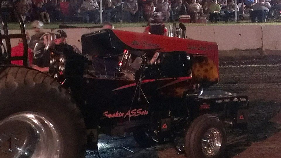

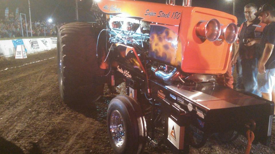

the driver hadnt been on a tractor for 2 years. we ran this tractor last year and got a late start this year. i have ran this tractor almost all of its life. final ration is around 19.1. we run a girdle. no deck plate but we had 1/2 grade 8 tie bolts that went through girdle to top of block and it broke all of those also. and ed on the pump yes gov housing was broke but we think it bent shaft where weights are.

Yes, with todays custom billet chargers you can easily get intake pressure of 200-250 with a 2 stage 3 charger system. There are quite a few single charger diesel tractors making over 100lbs. As for farmtoybuilders assessment of exceeding the limits of the little 301 engine, unless you run an aftermarket block [JD & IHC], all blocks can and will split thru the cam area when boost exceeds 200 lbs. If you youtube you can find numerous videos of such explosions of JD and IHC. We made a policy to always run ours as hard as we can each and every time we hook to a sled. That is what a light super stock is all about.

its the 301 motor. punched out to around 340. 2 turbos feeding one. made 200lbs of boost right before it let go.

The Smokin Assets team had a misfortune of splitting our 2nd block at Louisburg Ks on Saturday night. Jason's wife Traci was driving this time after being out of for 2 seasons and was on a killer pass when it let go at 235 ft when it let go. Not much salvageable from engine. It even got the injection pump and all the aluminum sheet metal. Very thankful no one hurt. It even popped the grade 8 bolts on the external tie bolt system.
