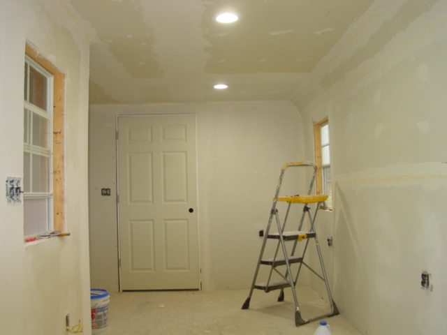

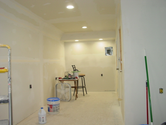

This old man is slower that a one armed wall paper hanger. Or the way it seems to me. It is closed in but I am finding the hard part is mudding over the tape and feathering it out with my weak hands and arms. I'll get it but it will take more time than I expected. I can only make about three swipes over my head until my hand is to heavy to keep it from shaking. I can set on the stool or back in the wheelchair for a couple minutes and make three more passes. Actually on this size room it should only be a couple hours work for a drywaller. I have been told hire a drywaller and have it over with. Anyone that actually knows me, that will not happen. Even if I am still at it next year.

Thin coats Dick , then you won't have to sand as much off. Wish you were closer but you probably wouldn't let me help anyway. Take it easy there young man. Looks like you got this. Nice job

when I had a pro do the kitchen, he made his mud, said the tub of premade is way too wet. told me to drain off the water,then mix for 5 minutes, let stand for 10. it was noticably a 'thicker' creamy mud. went on smoother and stayed in place. also don't fuss with it(brings water to surface,gets runny,arrgh !), got a ridge ? ,leave it ! it'll scrape off next day.only sand after the final coat(#3).

Just a suggestion.  I have always wet sanded.  You need to start out experimenting  with how wet you make the rag.  It's gotta be wet enough to rewet the top layer of mud.  As you work it, it will fill any minor voids you come across.  I preferred a terry cloth rag.  The best part is, NO DUST!  I've been complimented many times on my work.
