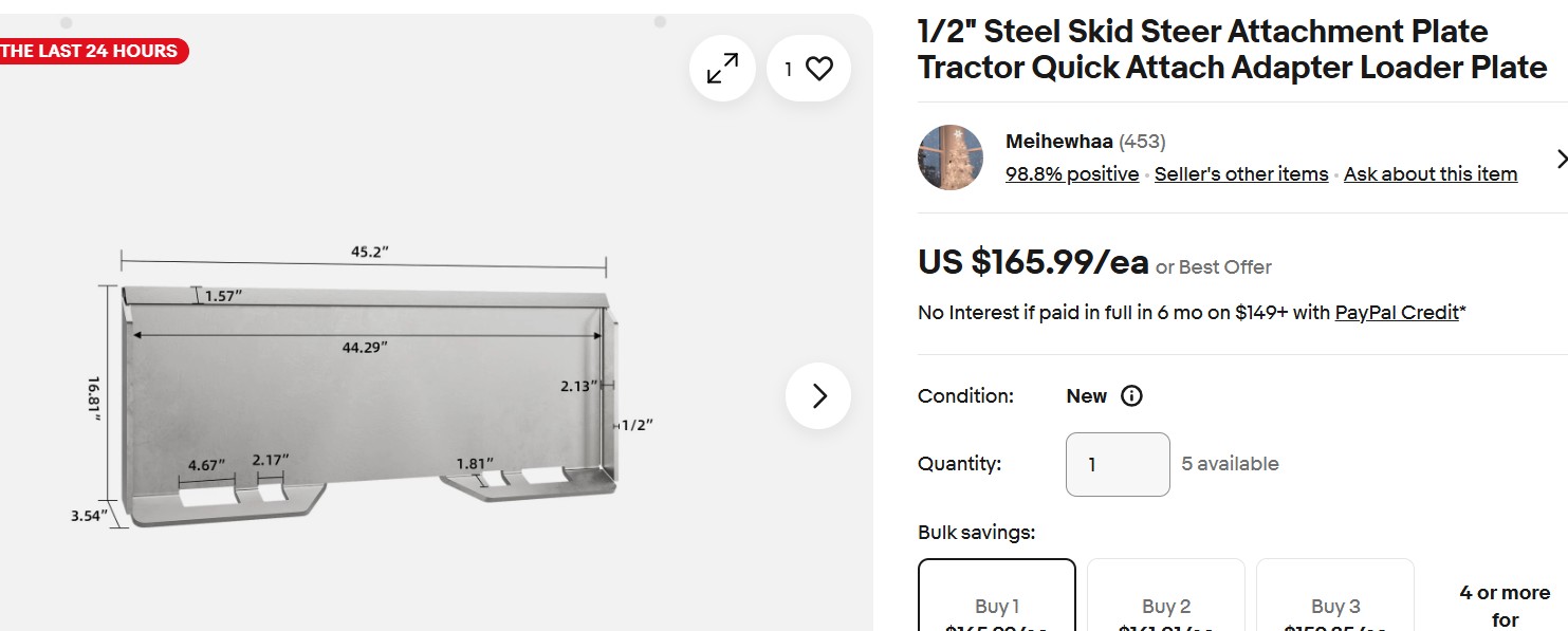

this is the PLATE that welds to the bucket or forks..... there are normally  4 LOCK holes at the bottom.. the OUTER TWO will be used by most tractors and skid steers... the INNER two lock holes are if you put on a MINI SKID and the boom is only 24- 30 inches wide, you can still mount the BIG forks or BIG bucket.
You dont need 1/2 inch thick plate... Im just showing this picture because it gave dimensions of the plate width / height / lock kholes.

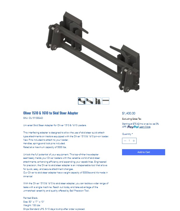

There is a place about 2 hrs from here that make adapters. Bell Precision tool in Shelbyville. They look pretty good. Thanks, Tracy

The biggest challenge is mounting the LIFT BARS onto your tractor.. Each tractor has a different size boom and pin spacing.. You can buy universal lift bars for  $100- 150. and then MAKE plates and weld to the bars to mount to your boom PINS.... Or if you dont want the challenge, there are companies that make SPECIFIC MOUNTS to fit SPECIFIC tractors.. You can Google "skid steer hitch to adapt to Oliver 1610" if your interested.. They are NOT cheap, but easy compared to design and build your own..
