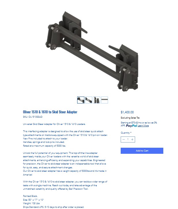

There is a place about 2 hrs from here that make adapters. Bell Precision tool in Shelbyville. They look pretty good. Thanks, Tracy

Post Options Post Options   Thanks (0) Thanks(0)   Quote steve(ill) Quote  Post ReplyReply Direct Link To This Post Posted: 5 hours 40 minutes ago at 6:14pm
The biggest challenge is mounting the LIFT BARS onto your tractor.. Each tractor has a different size boom and pin spacing.. You can buy universal lift bars for  $100- 150. and then MAKE plates and weld to the bars to mount to your boom PINS.... Or if you dont want the challenge, there are companies that make SPECIFIC MOUNTS to fit SPECIFIC tractors.. You can Google "skid steer hitch to adapt to Oliver 1610" if your interested.. They are NOT cheap, but easy compared to design and build your own..
