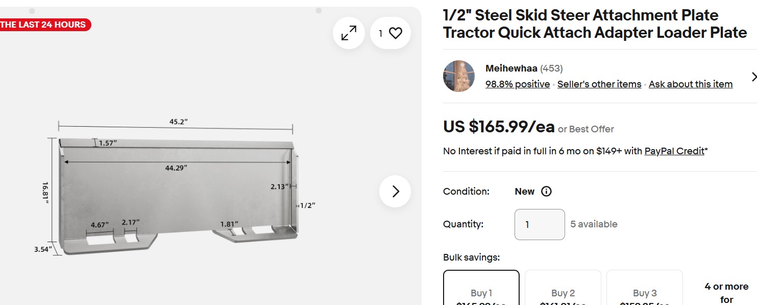

Pretty much... The plates vary by 1/2" depending on who makes it.... Basically the "PLATE" on the implement is 45 inches wide and and has a 45 degree back angle at the top.... the part you weld to the tractor / 3 point / loader arms is about 44 inches wide and has a 45 POINT at the top of the plate.. The tractor end can be two parts or one big part.. I just did this on an old GEHL... Cut the back face of the bucket off and welded on the 45 inch wide PLATE... then cut the old GEHL quick hitch HOOKS off and adapted the UNIVERSAL QUICK HITCH to each boom arm... I used two different parts for the tractor.. one for each boom arm... you can buy ONE complete mount..

Universal skid steer attachments follow the SAE J2513 standard, featuring a ~45-inch wide, 18.5-inch tall mounting plate with 1.25-inch tapered locking pins spaced ~31.6 inches apart. The top angle is 45°, while the bottom angle is 120°, designed to fit most modern loaders. Key specifications include a top hook-over, bottom pin-locking system, often with 5/16" or 1/2" steel.

this is the PLATE that welds to the bucket or forks..... there are normally  4 LOCK holes at the bottom.. the OUTER TWO will be used by most tractors and skid steers... the INNER two lock holes are if you put on a MINI SKID and the boom is only 24- 30 inches wide, you can still mount the BIG forks or BIG bucket.

what i found out is the PLATE that welds to the BUCKET should tilt forward and not be VERTICAL.. I forget right now, but something like 20 degrees ??? That gives you room to curl the bucket BACK when loaded.... not a big deal on the FORKS as they normally run LEVEL and not a lot of tilt back needed.
GOOGLE---
The standard mounting angle for a skid steer quick hitch (SSQA) is typically 20 to 25 degrees off vertical (or roughly 65-70 degrees from horizontal). This forward-tilted angle ensures that attachments properly seat, lock securely, and allow for optimal bucket dumping or proper positioning of pallet forks

Steve, you are a wealth of info. This is what I needed to know. What is average thickness of weld on plate? I have not seen one a half inch thick on anything around here. Thanks, Tracy

5/16 inch thick is probably the standard if you got a small skid steer or tractor like 30 HP... If you got 40- 60 HP you go to the 3/8 inch think.... The 1/2 inch would be for a BIG tractor that your loading a couple tons ( 4000 #) in the bucket..
