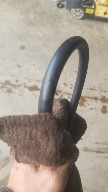

Sourced a new oil seal and was out in the yard punishing the tractor as a whole before placing it back into service when a hydraulic line for the lifting apparatus let go. Removing the line required removal of four other lines, and steering column from the tractor. I then found a pinhole in the return line to the hydraulic pump.
Simplicity in ultimate cheapness installed 400psi hydraulic hose. This is basically a good quality air hose. That is not a slanted evaluation as this hose is single fiber braided and marketed as "General Purpose Usage":

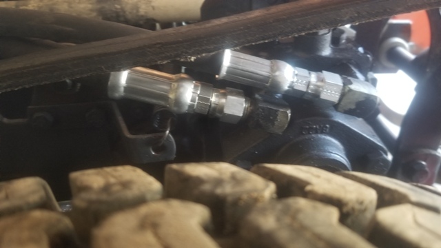

So nice to be able to fabricate your own hoses as needed that both fit, and route well as noticed the tiller drive belt getting into the supply hose in the original routing. I replaced all hoses with 3000psi quality 100R17 hose rated at 3000psi although the system will never generate that high of pressure. A new drive belt is ordered:
