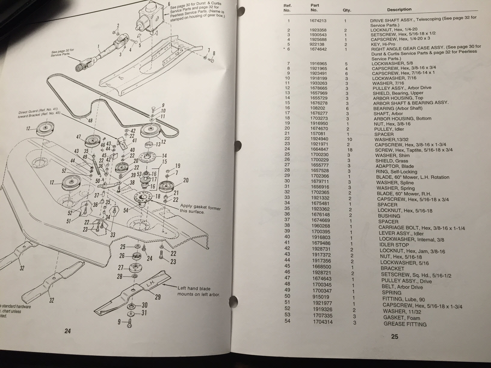

Would anyone know the Simplicity model numbers that's the same as a Deutz Allis 1920? Told them I had a DA 1920 got the ole blank stare, needing the bushings that center the blade on the arbor shaft , would think they are common on alot of Simplicity models

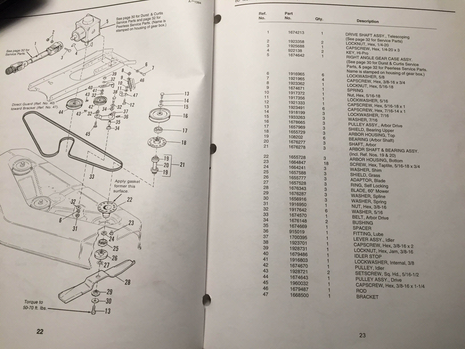

Post Options Post Options   Thanks (0) Thanks(0)   Quote DSpears N IL Quote  Post ReplyReply Direct Link To This Post Posted: 09 Apr 2017 at 8:28pm
Doug, I have a Agco-Allis 1920 lawn tractor and the manuals.
I have taken 2 photos of the deck parts and part numbers for you.
I hope that this is the information that you are asking for!
DeWayne
