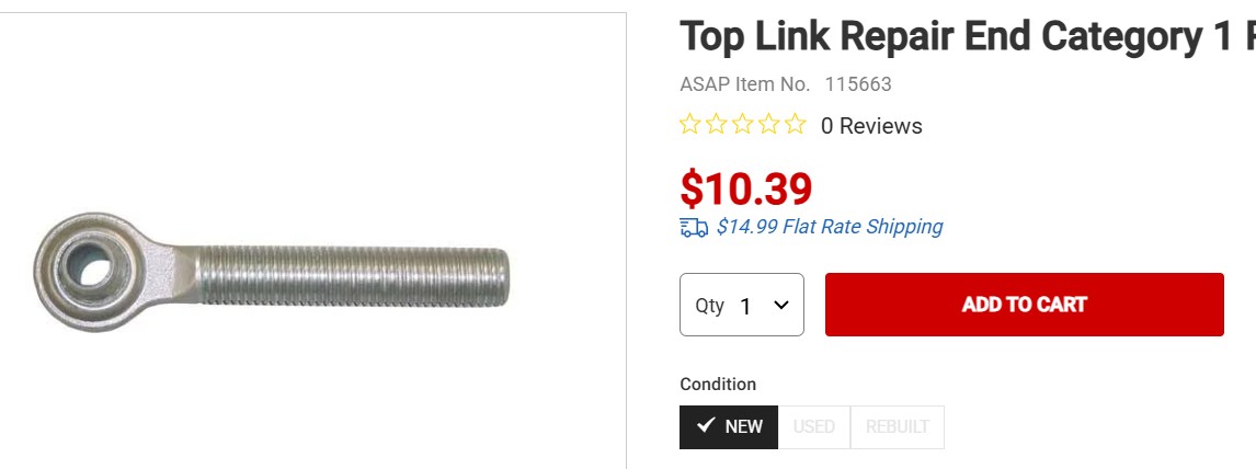

automotive TIE ROD END bolted to a  vertical plate on the BAR... and a steel strap welded to each side of the threaded bar and that bolts to the pitman arm ?
