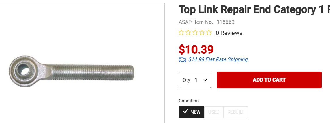

automotive TIE ROD END bolted to a  vertical plate on the BAR... and a steel strap welded to each side of the threaded bar and that bolts to the pitman arm ?

Post Options Post Options   Thanks (0) Thanks(0)   Quote steve(ill) Quote  Post ReplyReply Direct Link To This Post Posted: 14 May 2025 at 6:34pm

You already found the key point in the manual: the pitman and cutter bar are never perfectly aligned through the stroke, so the ball sockets are not a design flaw but a necessity to allow angular misalignment in multiple planes, and replacing them with a straight pin—even with a bushing or Backing Bearings —would almost certainly bind, crack, or tear something apart under load, so the best “modernized” fix is to rebuild the original forged straps with properly sized new spherical cups or weld in machined half-sockets that fit the ball tightly and use a high-strength clamping bolt, which keeps the needed 3-D articulation while eliminating the slop that’s been beating precision bearings your mower to death.
