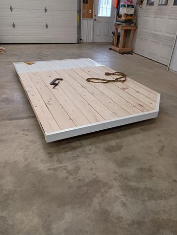

I have the main portions of the sliding door materials fastened to the frames. Next I was able to brainstorm the hangers. These just were not designed for these 4 inch thick doors. So I hacked them up and added extensions on the top. This will allow the hangers to adjust the center bolt at the centerline of the door. Also it will attach the bracket to the top of the door and provide strength to the bracket /door joint. And I will fasten these with 3 inch lags in 5 places each bracket for good weight carrying capacity.
The fab work:
Added a 2 inch wide extension that I crudely blacksmithed to shape:
Extending the slot to adjust for the door thickness and also add the two holes for attaching the top of the bracket to the top of the door.
Sandblasted after some weld smoothing, then a coat of primer and top coat of white.
The holes in the brackets were drilled out to accept 3/8 diameter lag bolts. Here is how they will fit on the door:

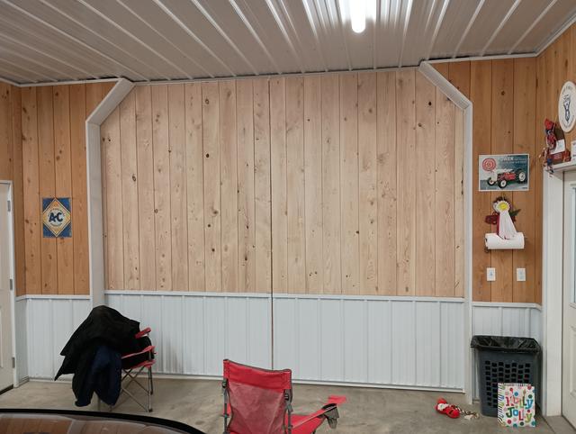

Some pictures of the continuing sliding door project in the shop.
The brackets attached:

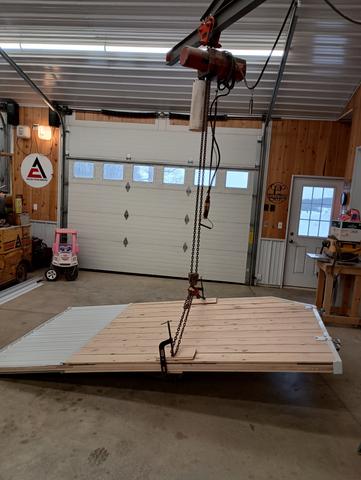

Adam helped me raise and hang the door on the track. Jib crane worked pretty good to lift the door.
The 45 design for ceiling clearance when door is open.
It is heavy , it rolls, kind of looks like the current walls, Still some of the edge trim to install when the other door is in place. I hope to be able to align the doors to close together.

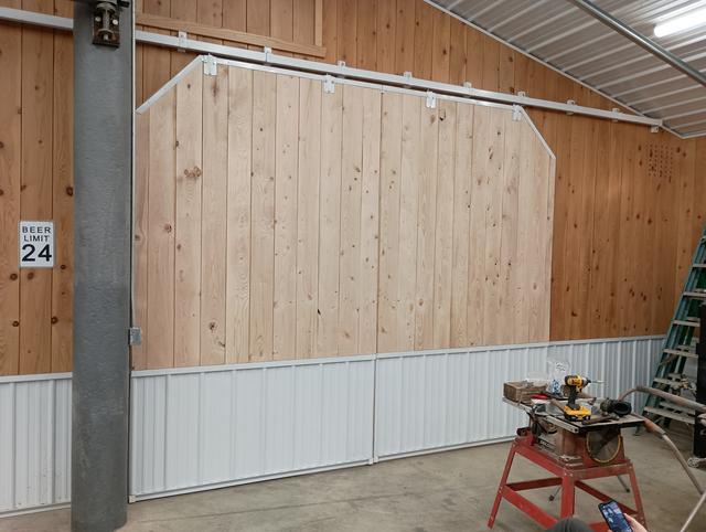

Allis folks,
Plummer , Thanks!
I got the hanger brackets installed. Both Adam and Eric were here tonight and helped me position the second door onto the track.
Some small adjustments and they are pretty close.
From the other room. The doors really make two rooms in the shop! Not sure how these will be used or how much we may use them? Time will tell. Another week of completing the trim and the wood finish. Adam found some flush/ inserted door handles that might work well on both sides of the doors.
