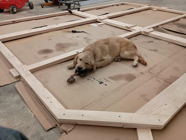

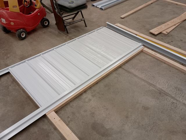

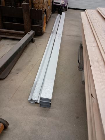

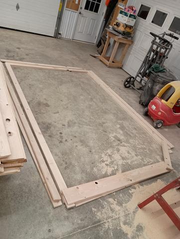

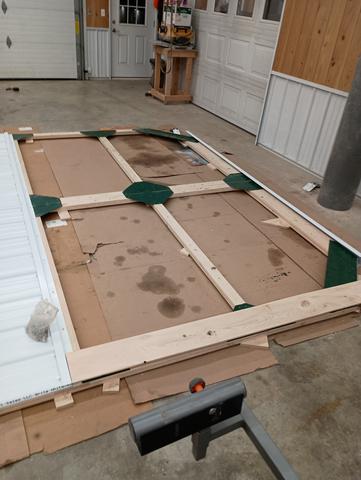

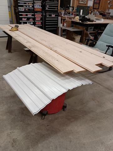

Materials for the 6 foot wide x 10 foot high sliding doors:
Getting some of the frame work cut to rough size. Planned and cut to width and rough length.
We had some cake for our anniversary and these napkins were brought to the party. Notice the Allis at the bottom center! 54 years.
The shop viewed from the tractor mini shop. Yes winter and cold temps. The D14 fired up and I plowed again this morning. Nice to warm up in the shop kitchen at 70 degrees!
Duke likes the snow but doesn't stay out long at 20 deg F. He has his bale of straw that he plays behind.

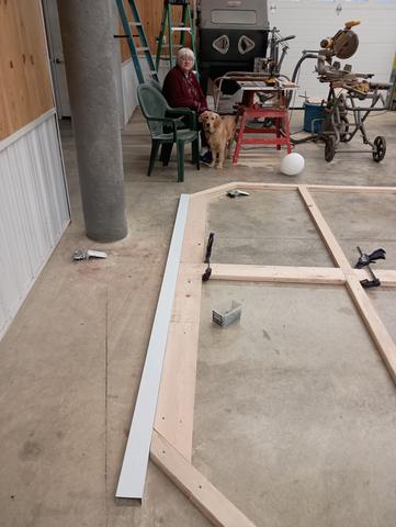

So the doors are starting to take shape. I have temporarily screwed this together as I cut the pieces to size. Thinking of using a structural adhesive between all the parts. May be over kill?
I checked this door frame for square using a 6-8-10 triangle method after it was tacked together. It was spot on. I had used a framing square as I assembled the hemlock frame boards in two layers. The white steel will be on both sides, and the hemlock will be above to match the walls. Since The doors will be 1/2 inch off the floor, I realized that the top dimension of the white on the bottom of the doors will be 1/2 inch higher than the existing walls. I asked Cheryl about the detail and mentioned that the white metal needs to be 1/2 inch shorter to match. She nodded in agreement. So I have to cut the sheets off.
The rest of the door project seems to be coming along ok. I keep measuring and checking the opening and the hangers/ rollers. Good chance they may work, move and fit and look ok. It came to me today that these doors (built mainly by Duke, I helped a little) may help define some areas in the shop for Cheryl to feel more comfortable and safer too.

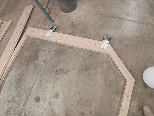

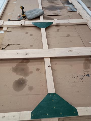

 worked on details of doors. Added a cross nailer for the hemlock boards.
Door hangers/ rollers, This is both centered on the door. I may move the left one more left? Considering taking the frame apart and gluing and the adding reinforcement in the upper section. Get one chance to over kill the project!
I did cut two panels shorter to make the existing wall trim and the door align better. More checking and double checking.

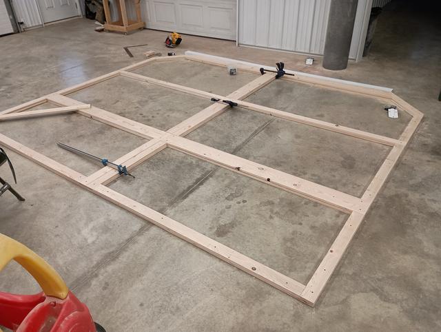

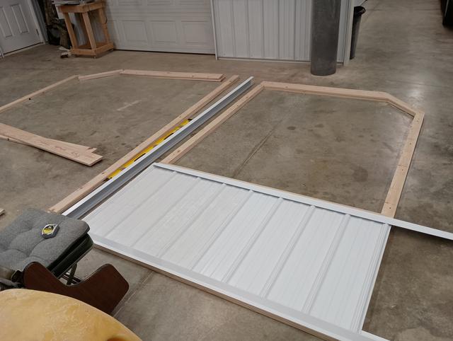

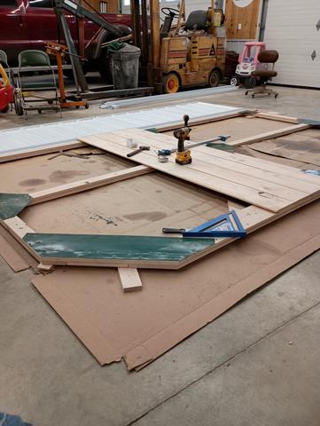

 I assembled the left door frame next to the right one. This made sure they were square and matched up. You might have wondered about the 45's on the corners? This allows the right door to open all the way and not hit the ceiling in the high bay area.
Checking with a straight edge:
I am going to take the frames apart and use structural adhesive to help strengthen the frames. I may also add sheet steel gussets at some of the joints. All the steel components are cut to size.  Oh yes if I am on the floor I have a good helper. Cheryl has been so patient also.

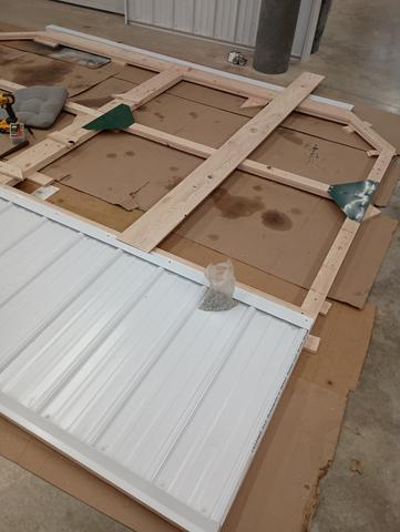

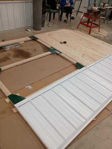

I use liquid nails to glue the frame pieces today. Proceeded to add the steel and trim to the lower portion of both doors. Then added the gusset plates to tie the frame together.
Next will be fitting the shiplap hemlock. Then to flip the doors and complete the other side.

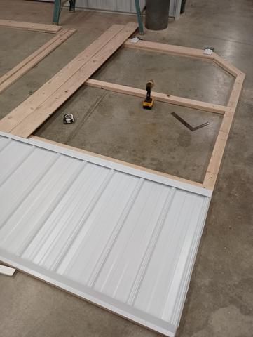

 Building doors not a huge job, but I keep taking pictures and posting updates. Why? Well Maybe it will help me get these done!:) Might help someone else at some time too?
We move along slowly, appyling hemlock.
