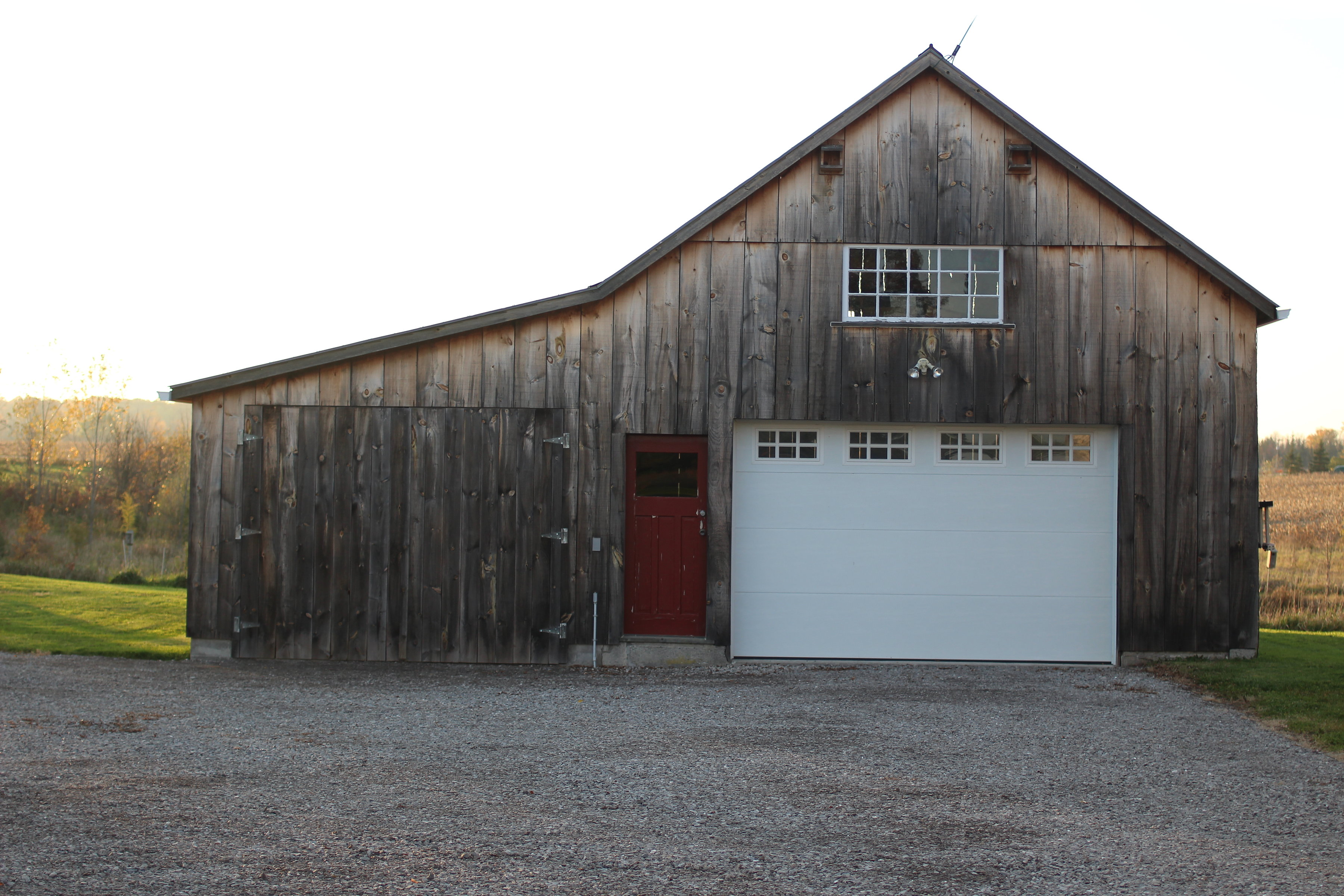

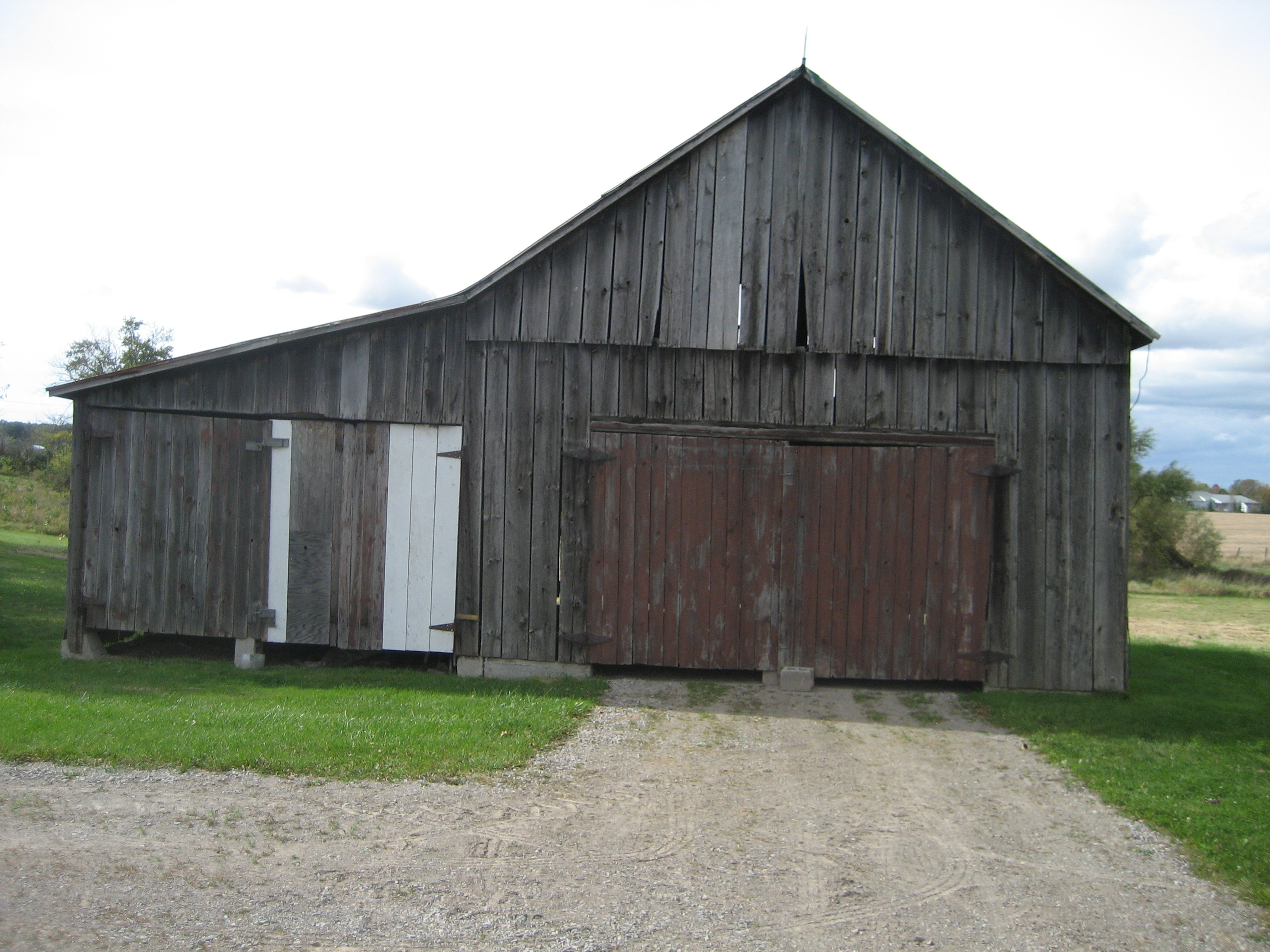

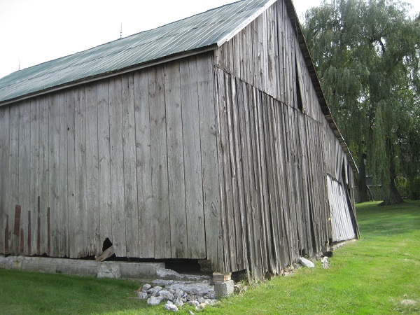

Hi All, As I said in an earlier post, when I came to my property in 2005, things were pretty badly run down. This included an equipment shed that I have since restored. It is about 30' X 34' and is post and beam construction. It is probably 100+ years old. As you can see, the roofing and the siding and the doors were in bad shape. There was not really much of a foundation under it and it had sunk and shifted and was way out of square and level.
I jacked it up and tried to level it and square it up and formed and poured footings and foundation all around it. I put a new steel roof on it. I stripped all of the old siding and redid it with 1" X 12" rough milled pine planks. I installed new doors and windows and covered the dirt floor with several inches of granular A gravel. I built a loft with 6" X 6" X 16' hemlock beams and 1" hemlock planks and built stairs to access the loft.
It turned out pretty good and should stand for a few more years. I use it to store tractors and implements and other equipment. The loft if full of 'treasures'.

I would say you done real good.... a little work but the final looks worth it.

Very nice.... should show a photo of the beam work inside.... NICE to save an old barn !!

Yes like Steve said need pictures of the inside work also, the outside does look good.

Looks nice, but like the others... Pics of the inside!
Nice job :)
Post Options Post Options   Thanks (0) Thanks(0)   Quote shameless dude Quote  Post ReplyReply Direct Link To This Post Posted: 17 Mar 2021 at 12:21am
you did a great job! it looks really nice!
