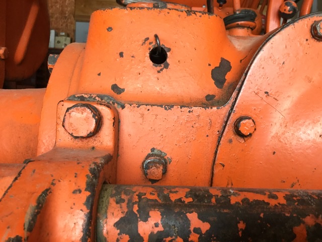

    Posted: 29 Mar 2021 at 8:08pm
wd45 has wd 63 36,seems like I am missing a couple numbers. Trying to figure out the year.Help would be appreciated.

Points: 54276
Post Options Post Options   Thanks (0) Thanks(0)   Quote DiyDave Quote  Post ReplyReply Direct Link To This Post Posted: 01 Apr 2021 at 5:28pm
Is this where you got your number from?
gramps tractor View Drop Down
Joined: 26 Mar 2021
Points: 17
Post Options Post Options   Thanks (0) Thanks(0)   Quote gramps tractor Quote  Post ReplyReply Direct Link To This Post Posted: 01 Apr 2021 at 7:53pm
yes that is where I got the numbers

No luck yet,cleaned the area with a brass wire wheel and the wd63 36 show up real well. Im going to figure out how to post a picture but I don't think it will help. The numbers and letters are very vivid. I appreciate you asking though. Thanks a lot!

I just looked out of curiosity.  The Serial Numbers for the 45 were:
Year                   Beginning number
1953                          146607
1954                          160386
1955                          190993
1956                          217992
1957                          230295
Ending Serial Number   230298
If your S/N starts with 6 then it ain't a 45.  It could be a 49, 50 or 51 WD.

The "WD" series officially began at serial number  7.   The first 6 tractors were prototypes. When they got to 127,007 they changed the transmission gears/shafts and used a curved gearshift lever. This new constant mesh, helical gear transmission was used in WD's from 127,007 on and all WD-45's from 146,607 to the end. So, if the serial number on the rear end housing is lower than 127,007  it will have a straight gearshift in it with a screw on knob. The only way it could have a curved shift lever is if someone used a torch and bent it, because a legit WD-series curved shift lever CANNOT work in the old transmission.  It doesn't fit. It also has a rubber knob that slips on the end, not a screw on knob.

ALL WD engines had a side plate on the right side of the engine block. ALL WD-45's did NOT. Now, if yours is a WD chassis, it either had a new block (WD45 block) installed one time or a complete WD45 engine.  There was a time in the past where you could not buy a WC/WD block (discontinued) and could only replace it with a WD45 block.

Are you saying the earlier serial numbers were wd not wd45? Thanks
Ed (Ont) View Drop Down
Joined: 08 Nov 2009
Location: New Lowell, Ont
Points: 1503
Post Options Post Options   Thanks (0) Thanks(0)   Quote Ed (Ont) Quote  Post ReplyReply Direct Link To This Post Posted: 18 Apr 2021 at 9:06am
Yes.
