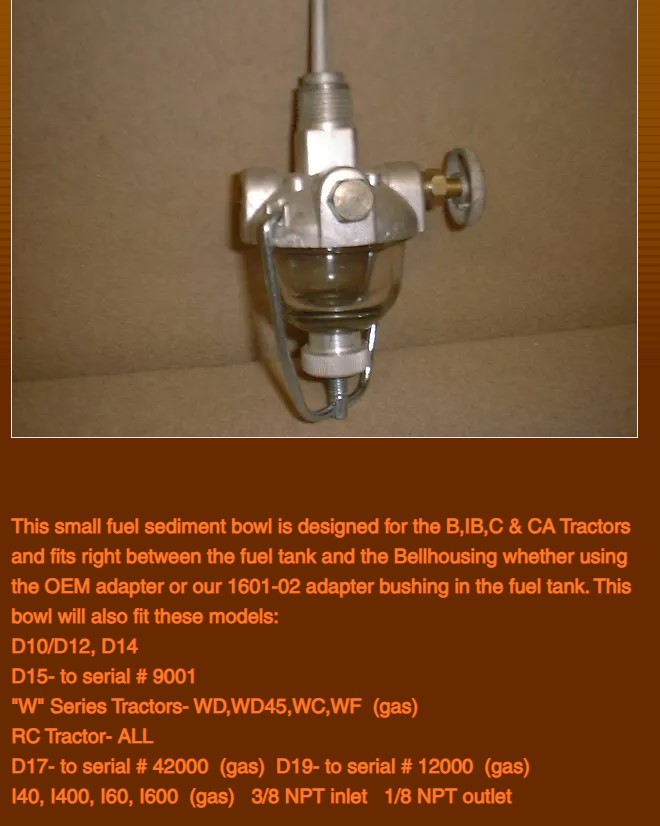

Can anyone tell me the size and thread pitch of the sediment bowl bung on a WD45 fuel tank. The old one was found broken off but there wasn’t much left in the bung. The threads in the tank need cleaning up. The new sediment bowl that I ordered was made in China. It looks really nice. We will see how it works

If I’m thinking right the hole in the tank is 3/8” pipe thread and the line is 1/4” pipe thread.
But others will correct me if I’m wrong.

Yup, the tank is 3/8 NPT, but the gas line is 1/4" tube ( O/D) not Pipe Thread.
