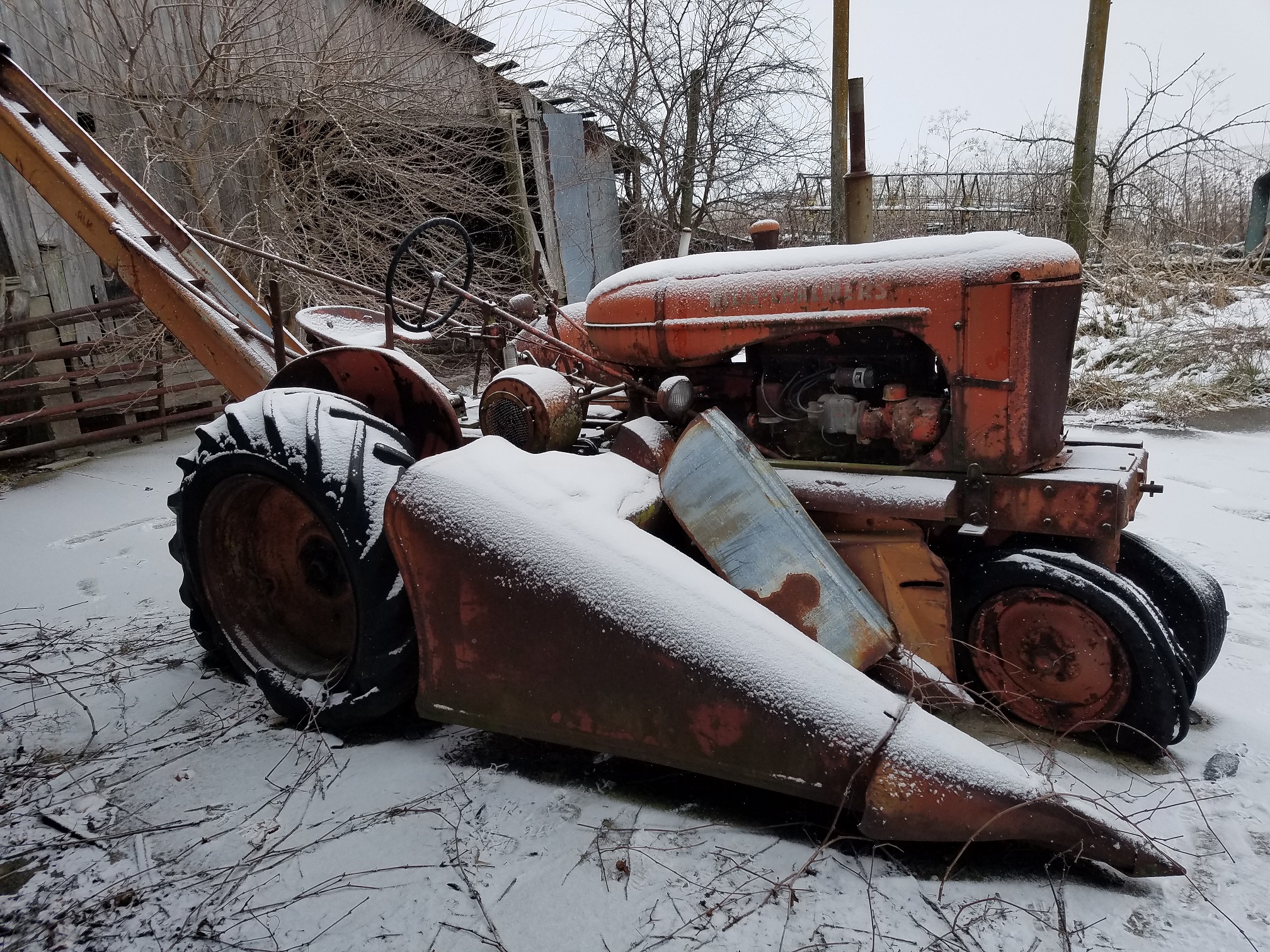

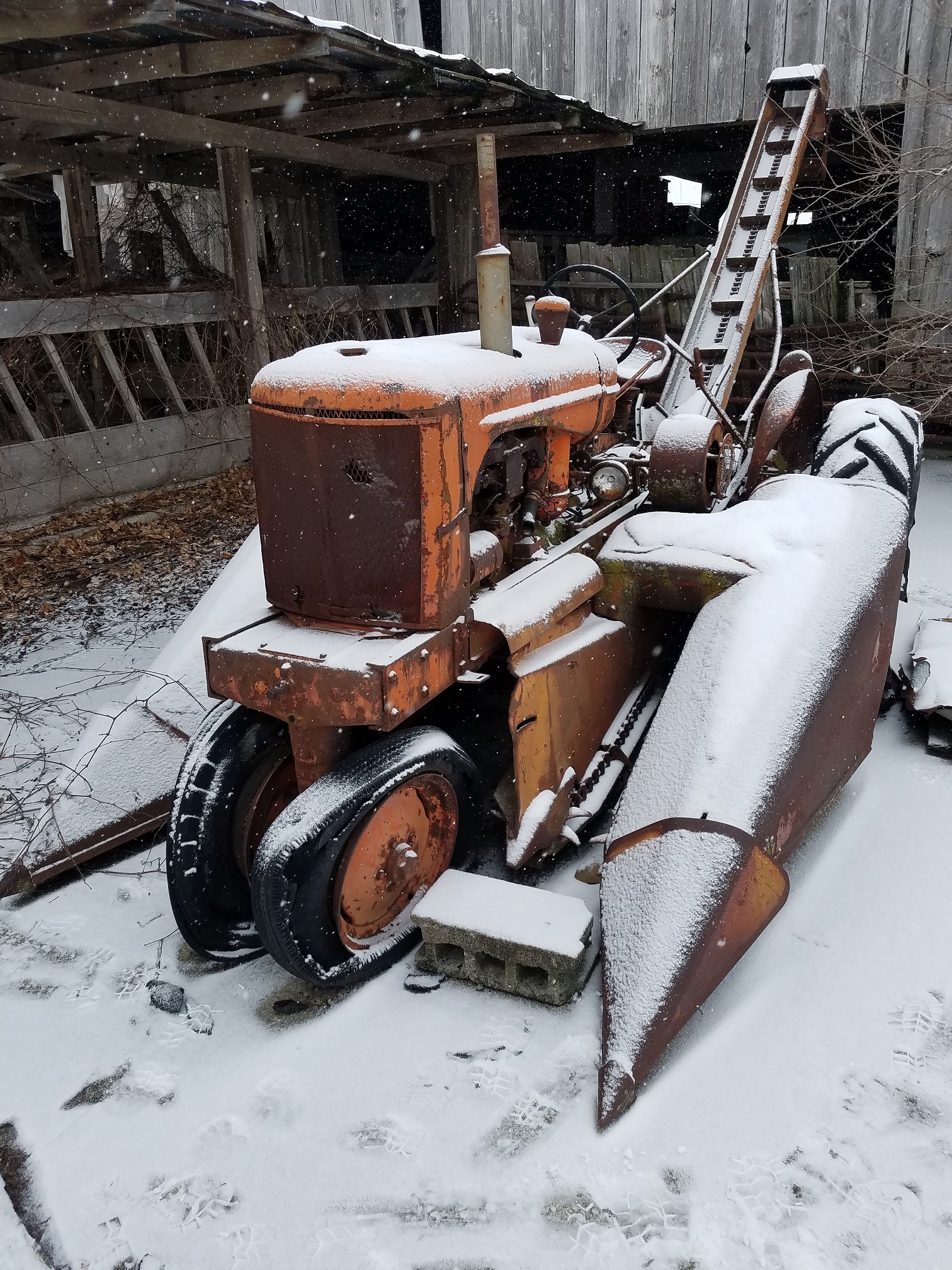

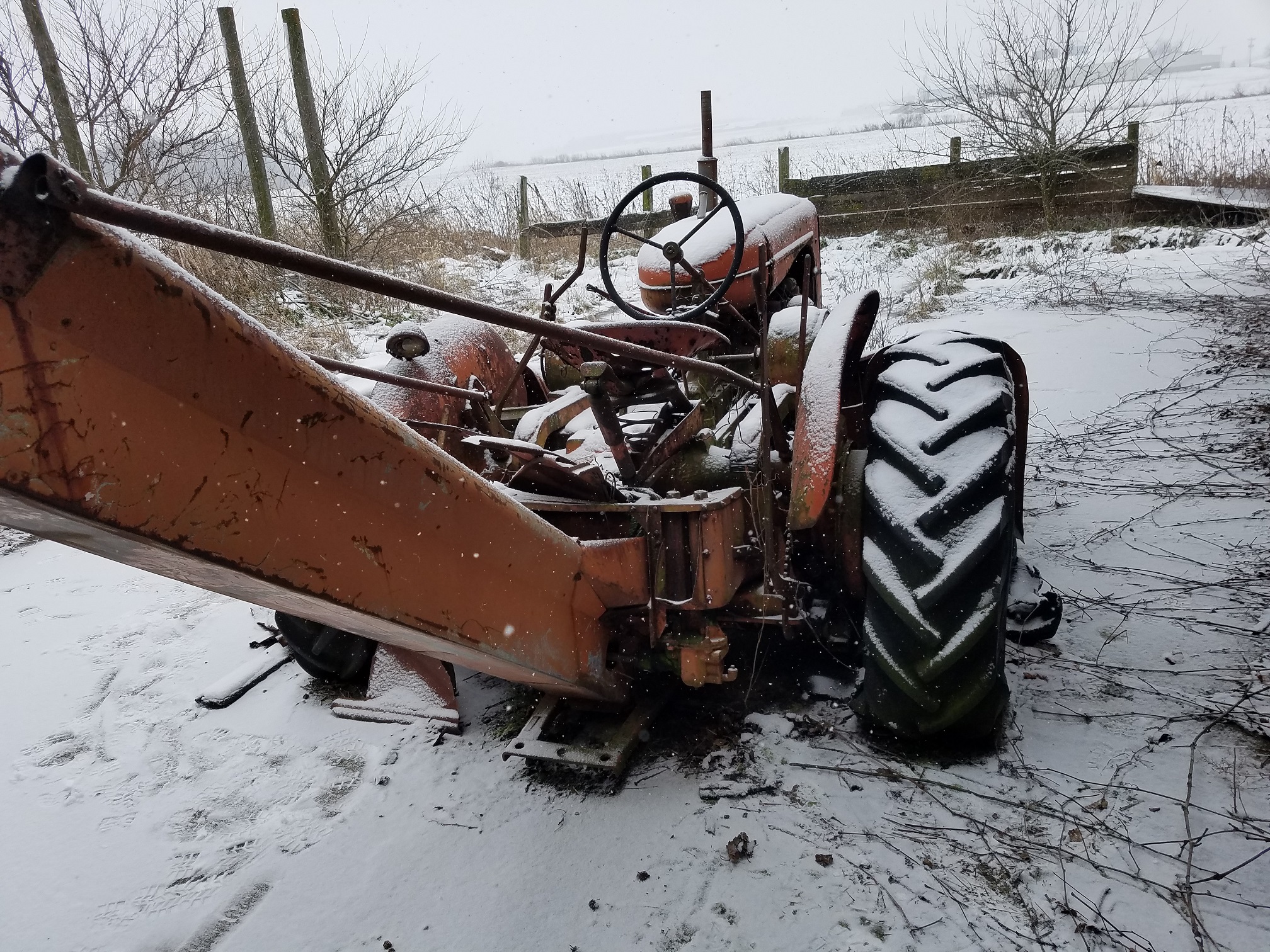

In the process of saving another AC from the scrap yard. Tractor/picker are located about 3 miles from my place. Tractor/picker sets on a cement pad located behind a barn. I can remember as a middle school student (10+ years ago), riding by on the school bus seeing just the elevator sticking up from the brush. I received permission last fall to walk back behind the barn and take a look at it. Been asking the old gentleman ever sense about selling it. The gentleman finally informed me this week he was ready to sell it. Here are a few pictures. Will upload more when I finally get it home. May need help identifying if the picker is a model 33 or older.

too bad he didn't move it over a bit under the roof.  Looks pretty straight.   Did you check if it was stuck?  Is the center snout around there somewhere?
If you buy it try to find as much about it as you can from the old gentleman- like everything it probably has a story.

Sure would have been nice if the exhaust was covered and it was under a roof.  Oh well, they can be rebuilt and made new again for not a whole lot of money.

 Looks to be a 33 picker, I would not go much more than 500 or 600 on it, probably stuck, will need tires  I has one on a WD and paid 1800 for it but was ready to go.  I sold it after several years because it just took up too much space in my shed and did not use it but once a year at most.  See if he has the front snout also

When you put the rear tires on, you might have them point the correct direction...

Picker is the first version simply known as the two row mounted corn harvester.  The 33 had the second lever for the quick adjustable stripper plates and the multi duct fans.  This one does not have those options.
I don't see the front divider in the pictures.  Is that around?

John, I believe the tires are mounted that way to get the correct width for wide-row corn planting spacing.  You would reverse mount the wheels to get the correct spacing for plowing.

I am wondering if that magneto has been changed to a distributor....????
Why else woulld it have a coil?

People have used coils on mag when the internal coil went bad.

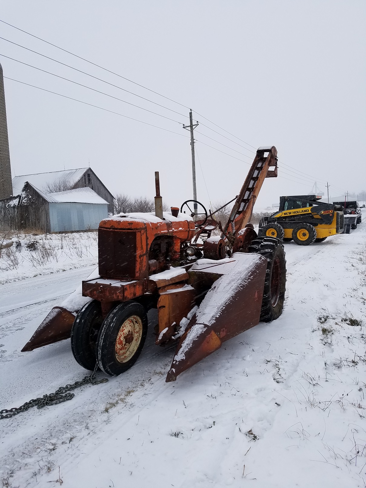

Getting ready to tow her to her new home

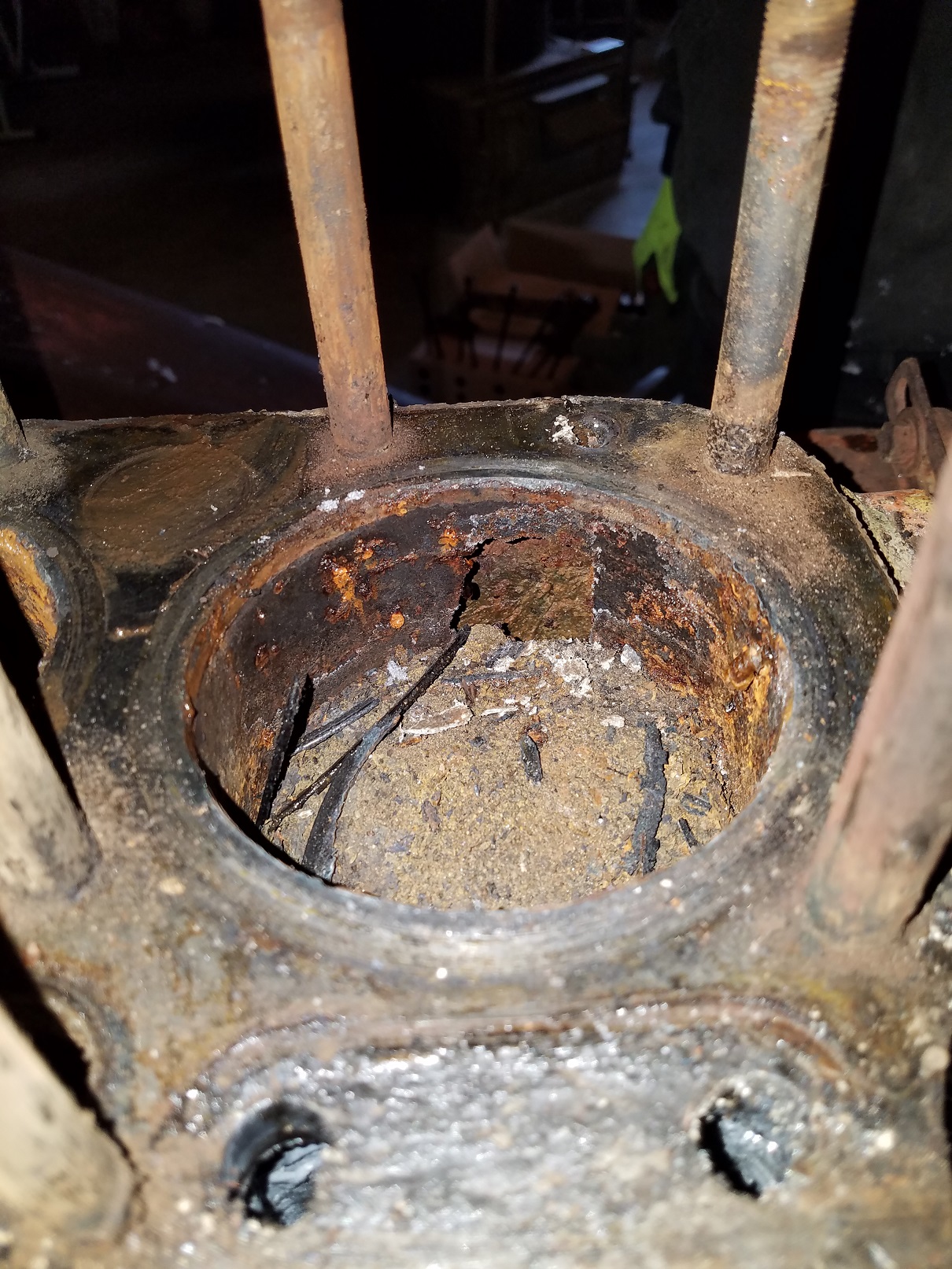

Pulled tractor into neighbors shop. Motor was stuck so though we'd better pull the head and see what mess we were getting into. Did not look very promising
Then we found a hole. Not sure if this was why the tractor was parked?

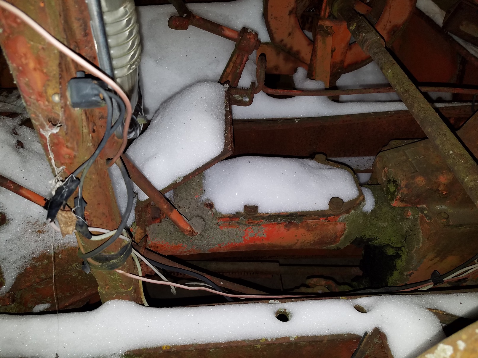

Also noticed what I believe is a transmission 'cut-out'? Believe from what I read this will allow you to cut power to rear axle on the fly and allow pto, belt pulling to continue turning, however you need to push the clutch in to reengage power to rear wheels if I am correct.
Currently I am weight for a manual so I know how to remove at least part of the picker. I've nover rebuilt a motor before and currently its hard to justify the cost of a rebuild when I have a motor setting. Plans are to drop a WD motor in as I have a good running one at home in a parts tractor. I need to make sure transmission/clutch are in workable condition before pulling motor. I will continue to update this thread as progress continues. Happy New Year to All!!!

Someone else will correct me if I am wrong, but I believe that you should have a hand clutch as well as a foot clutch... hand clutch would cut power to wheels but nothing else, foot clutch cuts out power to everything.

It's a wc not wd Ben
