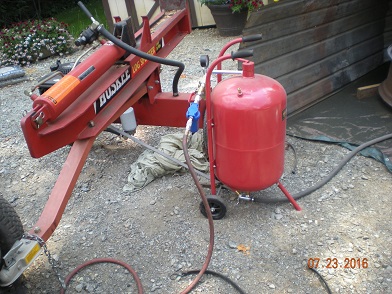

Can any of you seasoned sand blasters tell me how to keep my media from clogging in the bottom of my blaster.
   I spent most of my time banging or shaking the blaster or having the wife shake while I blasted
I am using fine media and have two dryers at the tank they are cheap ones so I thought two would be better.

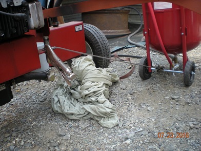

   As you can see by the pictures I resorted to vise gripping a piece of metal to the wood splitter and to the blaster to vibrate to keep the stuff moving.
   Surely one of you guys have a better way??

We usually only had that problem if the sand was either wet or the tank was low on sand.

  Hey Dave,,,you might check the outlet valve at the btm of the tank,,,that should be a "ball" valve or "plug" valve and NOT a gate valve as the sand especially the finer sand tends to work it;s way behind the gate and plug off the flow of sand. As the other guys said,,,Wet sand will do it every time. What kind of pressure are you runnin on the pot?

I have one like it but only used it a few times. As I remember, which could be disputed, I had to restrict the flow of sand out the bottom. I couldn't have the valve wide open.  Air volume was my main problem so I bought a cup sand blast gun.  Course stone grit is what I use in the tool shop and I use a pail of grit with a cheap HF vacuum tube deal on big stuff.  The fine sand gives sand flow problems in the tool shop blast cabinet as well. Glass beads work the blast in the cabinet.
I bought course washed sand at a gravel pit and had it stored in the warehouse that worked well after it dried a year.  When I was running 24/6 one icy night it got used in the parking lot and drive.

When I bought mine it drove me nuts the first day. I had to learn where to set the valve on the bottom of the tank. Once I learned that it still gave trouble. I finally found a small piece of styrofoam peanut in the hose. I sweep a big spot clean on my shop floor and spread out the sand to help dry it. I keep a box fan a ways back and let it run a few days. I never had enough air to be very efficient  I ran some fine Black beauty through it once and had my best luck with it.
On my blast cabinet I use Black beauty and have good luck. I sift it frequently and heat it with a heat gun if moisture becomes a problem.

    Dave,,there is a "orifice nozzle" in the hose that has to be sized to your available CFM. If it is too big for the volume and pressure of air you got available,,,the compressor will not build enough pressure in the pot to keep the sand flowin,,,,The available air, the flow valve at tank, and the nozzle at the hose all GOT to be sized or the system will continue to give you fits,,, These pressure pot type of blasters are notorious for using huge amounts of air,,,,,!!!!
    Like AJ says,,,the gravity flow blasters are lots more efficient,,,but since you are blastin those big wheels,,it would take a really big cabinet,,,,,,WinkWink

I have one just like yours only gray in color. Yes indeed you need a ball valve in the bottom of the tank to help in regulating the amount of sand. I found I also needed a AIR DRYER in the air supply hose and it worked best at 11CFM at 40 psi. Keep in mind you will be getting more ball valves unless you can run it wide open as the sand will eat away the ball till it does not work.

   dessertjoe, my press at the tank is 110psi, compressor is on the low end at 10.5 scfm @90psi, 6.5HP. I blast for a bit then let it catch up.
   I started out with Black beauty 12/40 which I think is just too big for this out fit, then got some Black diamond 30/60 (fine) my tip started out at 1/8" but I used a diamond burr in a dremmel tool now its about .1800" in dia maybe too big now.
   You are correct alleyyooper the cheap driers I have aren't getting all the moisture I now see a little rust on the inside of the cap on the tank so Im getting some moisture in there.
   Several of you mentioned adjusting the valve at the bottom of the tank which is one thing I didn't do I just left it wide open ,I will try that today and it is at least a ball valve.
I want take all fittings and valves off of this thing anyway and re-do the pipe thd tape who ever they had taping up these fittings somewhere in china I think they had stock in the pipe tape company, their may be some tape balled up in there restricting the flow.
   Thanks for all of your input I will try your suggestions with what I have and what I don't will be on the wish list.

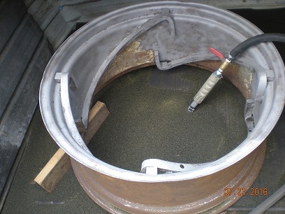

   No I don't not have a large cabinet, In the one pic you can see part of my makeshift "blast box" I used metal roofing for the sides with a tarp on bottom and part of the top so I could re-use the blast media.

Ok, you guys nailed it, it worked a lot better today I got more done in 1/2 hr today than I did all day yesterday.
   I had the same set up except didn't use the wood splitter or the wife to shake the blaster.
   I put a 1/8" tip back in then cracked open the bottom valve just till I had media coming out of the gun.
And just as desertjoe just said as the level of media in the blaster got below about 1/2 full I had to re-adjust the bottom valve.
   Just as I was finishing up I could tell I was getting moisture because it didn't want to work at all.
Thanks again guys for your help.
