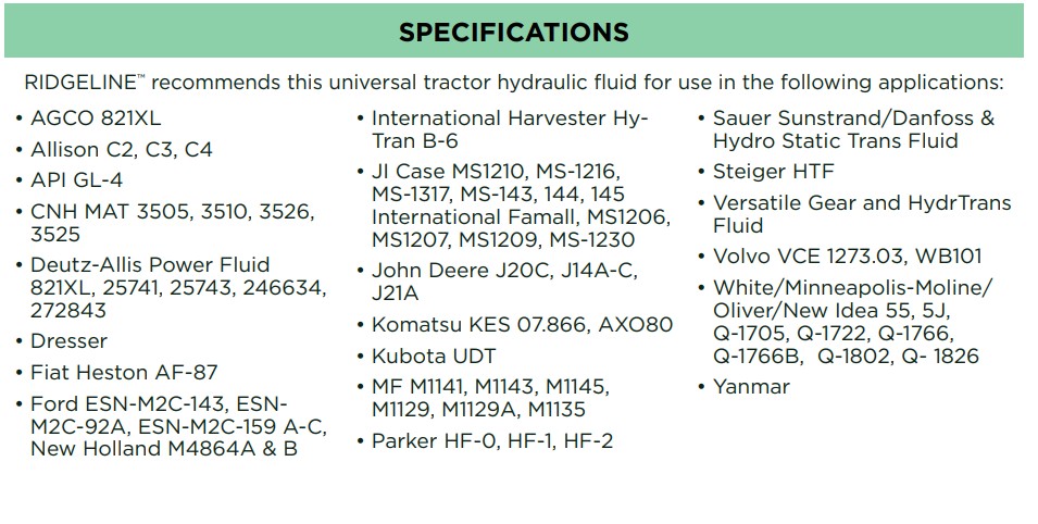

Post Options Post Options   Thanks (0) Thanks(0)   Quote steve(ill) Quote  Post ReplyReply Direct Link To This Post Posted: 15 May 2025 at 3:43pm
today ENGINE oils have a lot of addatives related to combustion / gasoline / heat... You would be further ahead with a good HYDRAULIC OIL... Most of them are in the 20w catagory... some are even multi viscosity.. a GOOD oil should not foam... Look at the back of the jug and see that it meets several specs from Allis / Case / Ford / JD / CAT... then you know your getting a quality oil.. If there are no SPECS, then its probably a cheap quality oil...... You can get this at FARM store, NAPA, ow Wal Mart..
BRAND is not important... SPEC should look something like this...
