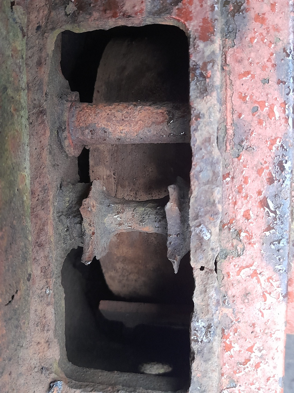

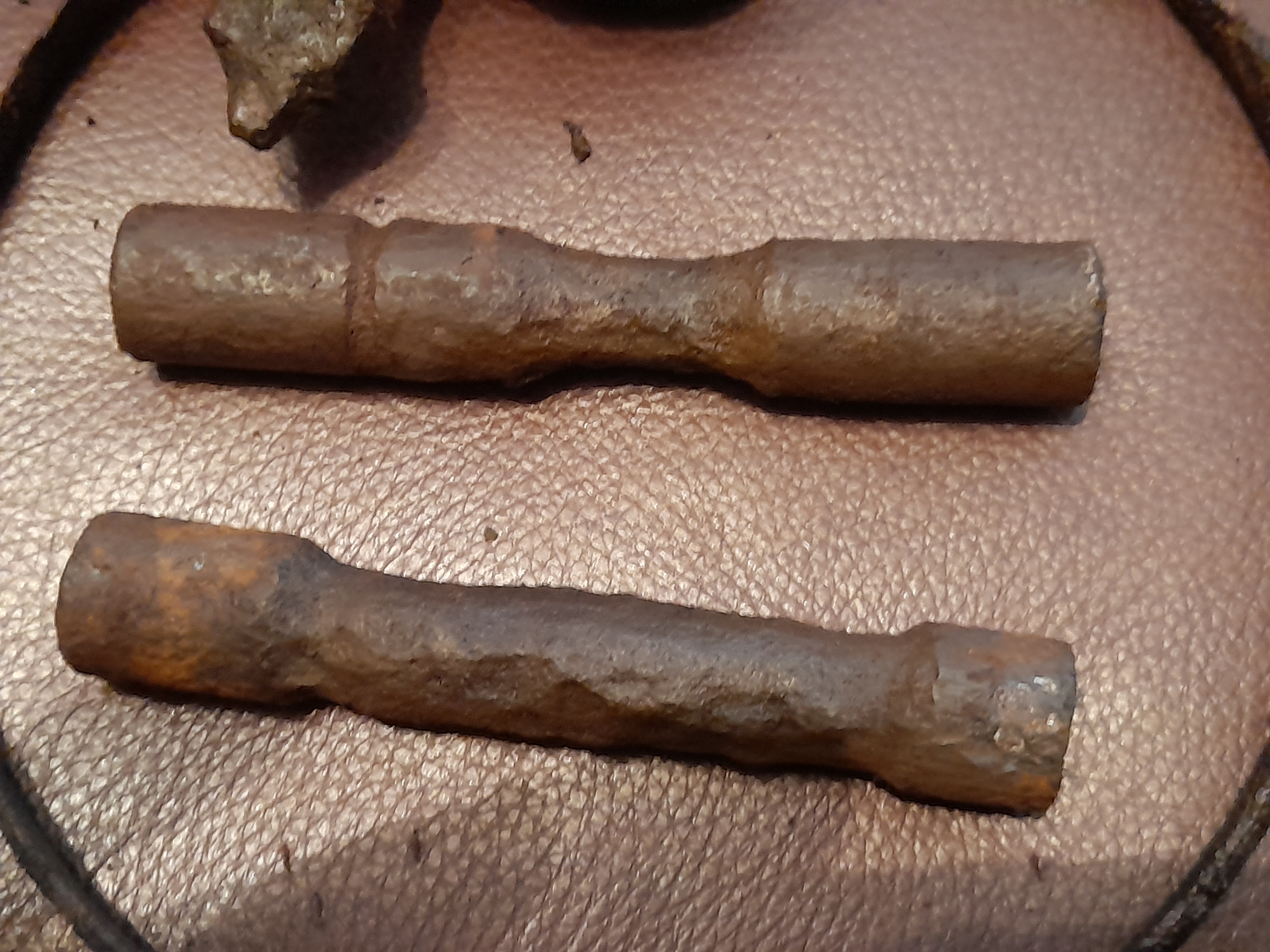

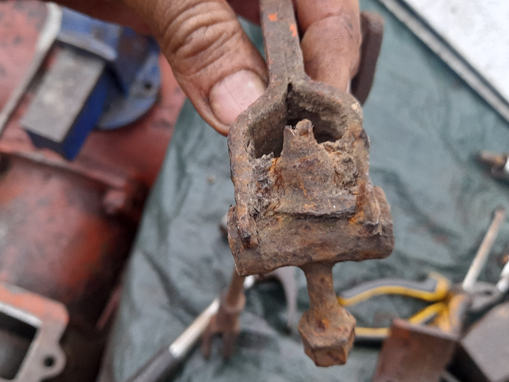

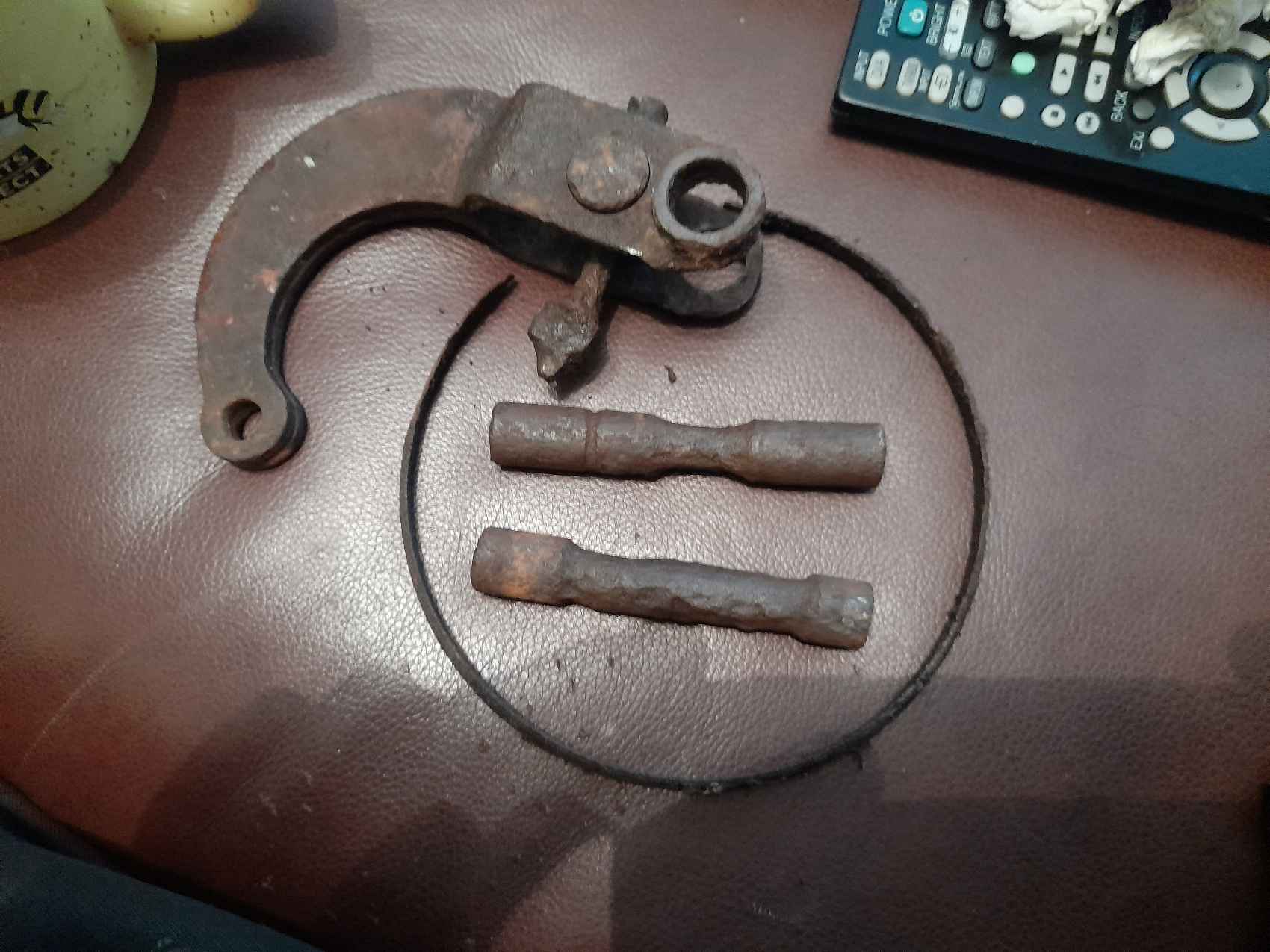

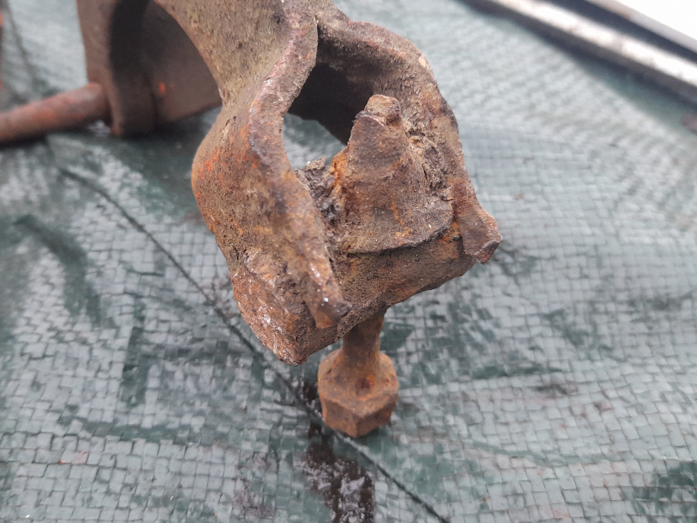

Just a couple of photos of the remains of the brake pins & toggle from the left side of the '41. This is the "good" side in that the toggle arm isn't rotted completely off...
There's a chunk of drum that's rusted right off the inner edge so probably needs new drums, that it isn't going to get any time soon!
Also, the rear housing seal must be that bad from the amount of grease mixed with the mouse nest inside the "trumpet" that it's actually saved the hinge on the brake band, which broke loose and came back round with a clean & working some oil into it.
The friction material is pretty horrible but mostly in one piece so plan now is to remake the rotted off ends of the bands & rivet that back on (paying mind to the fact that it will 150% be full of asbestos, I believe it's original) UNLESS I can find a source of friction material to suit for less than about £10. All it needs is to be able to have SOME brake, better than zero.
Here's hoping the diff seal is as bad on the right side so I can save that hinge too! Friction material actually looks better that side...
Edited by ekjdm14 - 08 Feb 2025 at 9:12am

DANG... i have seen some rusted ones... but NOT that bad !

If it had 3 point, I'd swear this poor thing was a yard scraper all it's life!
Ever seen the edge of the drum rotted right off too? lol
Edited by ekjdm14 - 08 Feb 2025 at 9:16am
Points: 88615
Post Options Post Options   Thanks (0) Thanks(0)   Quote steve(ill) Quote  Post ReplyReply Direct Link To This Post Posted: 08 Feb 2025 at 9:17am
Seen drums that had deep score marks and probably 1/8 inch too small in diameter.. Have busted a couple getting them off... but never seen one ROT in place..
you got enough left to replace the linkage and get the brake band to grab the old drums ?
Sooo, they'll go again, right? LOL
ekjdm14 View Drop Down
Joined: 20 Aug 2024
Location: Alsager UK
Points: 987
Post Options Post Options   Thanks (0) Thanks(0)   Quote ekjdm14 Quote  Post ReplyReply Direct Link To This Post Posted: 08 Feb 2025 at 9:26am

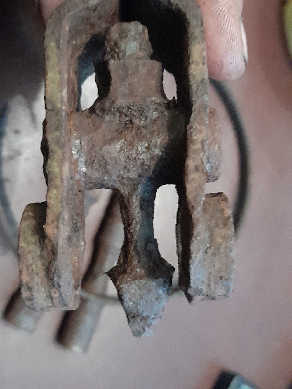

Will have to try and get a measurement of the drums, but the left side is DEEPLY pitted rather than scored, I'd bet they're way undersize.
Should have enough here to be able to remake this side brake band "custom" & have enough adjustment.  Other side I haven't looked closely at yet but I know part of the linkage is flat out missing & the toggle is rotted off. Will be a huge rig up if I even get both sides to work (I would like to though).
I think the biggest surprise to me really, is that anything even came apart/moved back here without resorting to heat/power tools. (EDIT- I should add the caveat here, no heat/power tools YET! hopefully not already activated Murphy & his law).
Edited by ekjdm14 - 08 Feb 2025 at 9:29am

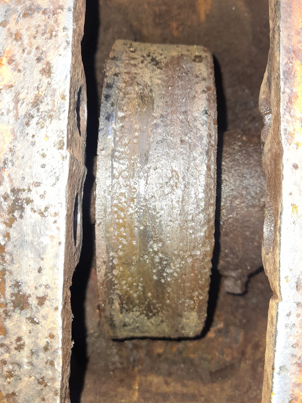

Here's the right side toggle, now I look at it the pins & drum actually look better than the left side so there may be some hope after all.
Can't find a spec for drum minimum size (I've only got an IT book don't think they give the specs) but roughly measuring with a tape through the hole I'd say the left drum is approximately 5 5/8" diameter at the most, maybe 5 1/2".  Would imagine they started at 6" new? Pretty darn bad anyway, feels like the friction surface is maybe 3/32" thickness.
Points: 88615
Post Options Post Options   Thanks (0) Thanks(0)   Quote steve(ill) Quote  Post ReplyReply Direct Link To This Post Posted: 08 Feb 2025 at 10:01am
yea, that drum has a LOT of wear.. I have removed them and turned on the lathe... I have run the tractor in first gear with the wheel up and FILE and Strap Lap ( sand paper) the disc to clean up some damage... but i never had one that bad !!

Yeah they're not good at all. Probably just run what I brung until they actually break apart & at that point consider whether I can invest in replacement drums & bands.
The old girl is starting to grow on me quite a bit, she's trying her best to work with me & my hack fixes so it's just a case of if I end up using her enough to justify real repairs. In other news though, we may be moving to a more rural area this year so that could facilitate more opportunities to get in the saddle. Here's hoping!

And, just like that, we have some semblance of brake on the left side now.  I did reuse the original linings for the moment but there's plenty of adjustment in there to be able to go to tire strips when that wears away.
The right side promises to be more of a bear to get sorted, have to make a toggle for that side too. Hopefully get some metal for the rim soon & have her back on all 4 wheels again.
