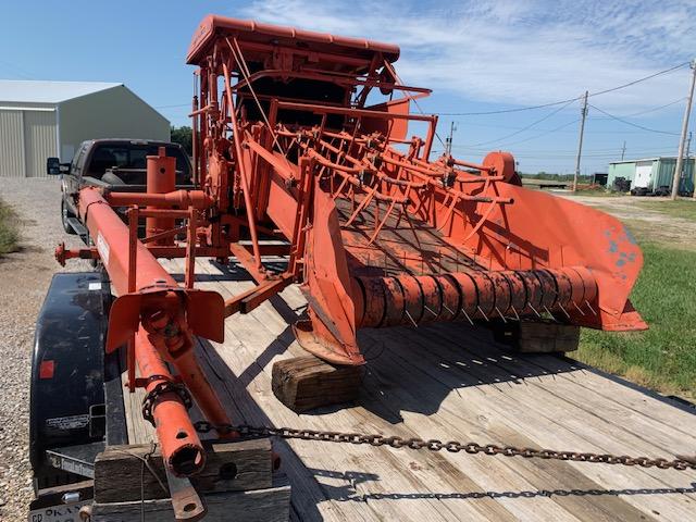

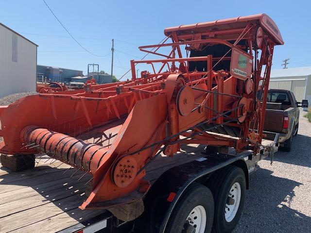

Purchased this baler in CO. and have never seen a model like this and hoping someone can shed light on this.  I originally thought it was a farmer modified pickup but the drive gearbox has been extended 5 inches with a cast iron factory housing.  Comments and information welcomed

Is this the one that sold previously about a year ago? Draw bar looks different as well. Usually they are square, that one is round

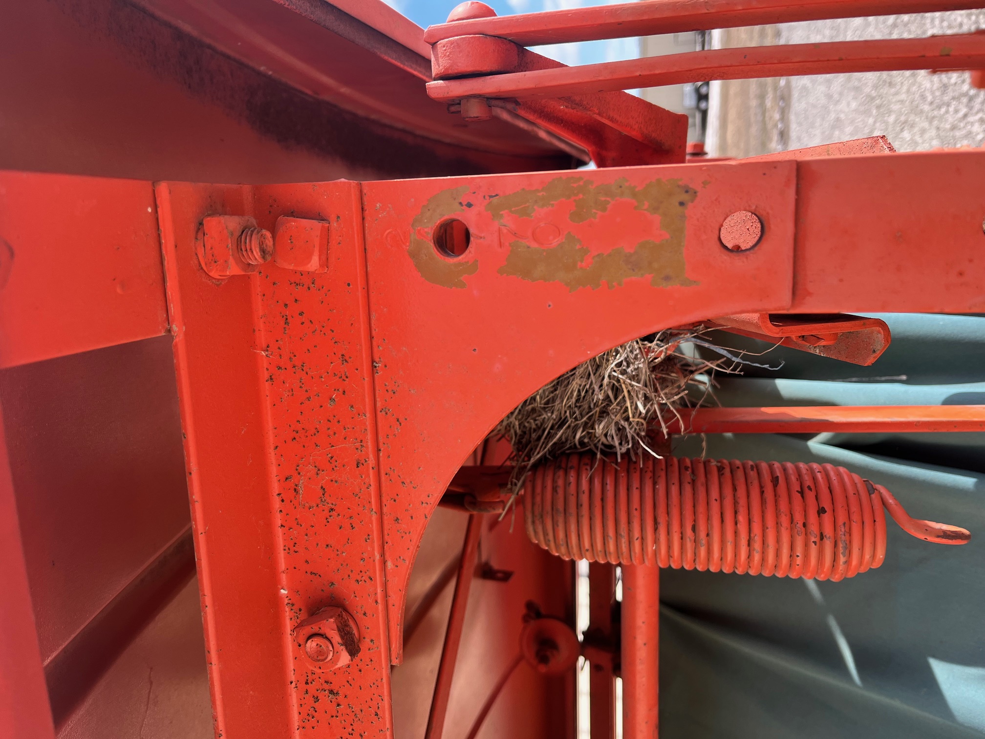

Someone drilled a hole where the serial number is but believe it is 24770.  This is the one sold a year ago.

Trying to figure out the point of this modification. My experience is the baler works best when you maximize the amount of hay you are putting into the baler . That bale loader feeder style will hamper that.
On the other hand maybe if the hay is thin, this style of feeder, coupled with that conventional pick head , will feed the baler more evenly(no odd shaped bales).
I know even after Umo's family sold the patent, they were getting rotobalers from allis and making modifications. I wonder if this is one of their"project" balers

Could that serial be 24770??? Fair bit missing cause of the hole!!!

There is only 5 numbers, I took a magnifying glass and checked it again.  Is there a serial number breakdown for what year this serial number is?

The point of modification is still the million-dollar question.

According to Norm Swinford's book serial #24770 is a 1950 model.

I remember seeing this when it sold on the auction and saw discussion on Facebook.
I can only assume that someone wanted a more positive feeding system for baling some more stemmy material or something else that wouldn't feed into the baler well?
Im guessing that more than one was built judging by the work and design that went into it but so far this is the only one I have seen.

Looking at the OP's pic, I'm thinking more and more it might have been a similar adaptation to make for continuous baling: It has the spreader bars sticking down to meter out hay and block it from piling into the chamber during the tying cycle. The pickup reel appears to be driven from the same countershaft as the Kelly Ryan one - making it so that it will keep picking up and piling onto the apron during the tie cycle. It all depends on whether the feeder forks stop when the tying cycle starts - we'd have to see a little more of that mechanism to know for sure. If the feeder forks stop when the tying cycle starts but the pickup reel keeps picking up, it's almost certainly an adaptation to try and make for continuous baling:
- Tying cycle starts, feeder forks stop, but pickup reel keeps picking up and piling into the feeder forks.
- When tying is complete, feeder forks start moving the accumulated slug of hay into the chamber, with those upright bars metering the hay out so it goes into the chamber (somewhat) uniformly.
Or at least, that would have maybe been the theory. Like the #10 and the Kelly-Ryan version, I'm pretty sure it wouldn't have worked well unless you had a smaller windrow and dialed back your ground speed. And then (just like the #10's) your limiting factor for bales per hour would be the smaller windrow/slower ground speed, so you're one step ahead and one step back. And (like the #10's), because it varies between very light feed during normal operation and very heavy feed when the recirc slug makes its way into the chamber, it'll be very hard to make consistent, controllable, predictable bales and keep the adjustments correct. Because (as Dr. P. notes above), to work best, you want to maximize the feed into these balers. So you're actually one step ahead and two steps back. To come close to working well, I suspect you'd need the electric gearbox switching option that the later rotobalers had, which kicked the tying cycle into hyperdrive. My understanding from that coworker whose father had a #10 was that when the #10's were set up well with a small windrow and the electric gearbox switch was working properly, they could 'almost' do an ok job of continuous baling. If you held your tongue just right.

As for the baler in this post, it is not set up for continuous feeding. The head is being driven where a regular platform would be driven meaning it will stop when the tieing system is engaged.

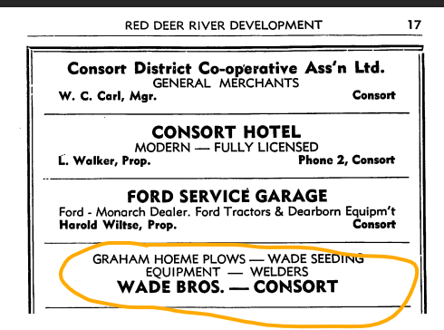

This is what happens when I spend a day stuck inside with a newborn and unable to do anything more productive - going down an internet rabbit-hole searching for details on obscure 70 year-old aftermarket pickups for a baler model I never liked in the first place... Sigh...
It appears 'Wade Bros.' was indeed a fabricator & equipment dealer in Alberta, somewhere between Consort and Naco.

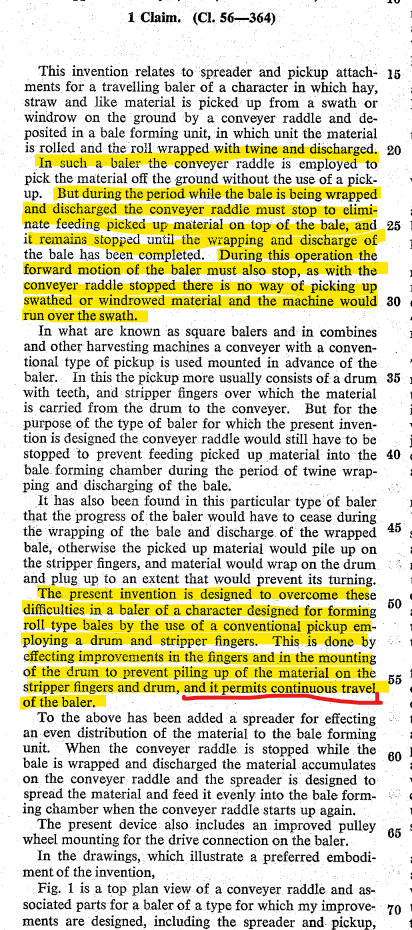

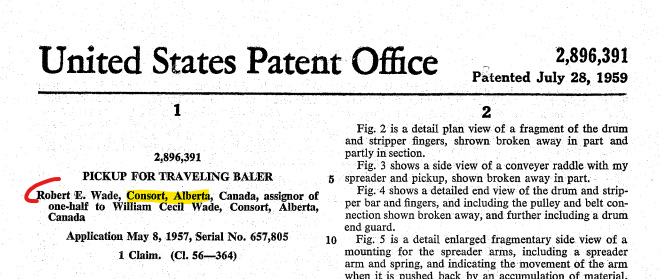

Bingo: Found the original patent from Wade relating to their continuous pickup for a rotobaler. They clearly couldn't (or didn't want to) specifically mention 'Allis' or 'Rotobaler' in the patent application for liability and/or adaptability concerns. Read the two highlighted paragraphs in the lowest picture for mention of 'continuous' operation. https://patents.google.com/patent/US2896391A/en?oq=US2896391A
