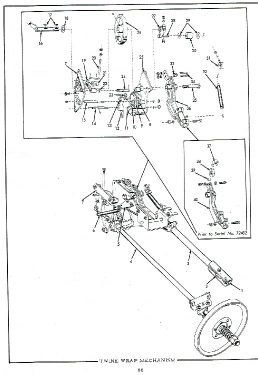

I'm having a problem hooking up a spring. It's part of the twine wrap mechanism. It hooks behind the big gear on the left side. I raised the stop the twine tube sets on, and when the tube fell down about the middle of the baler, it was closer to hooking, but I still was not man enough to stretch it and hook it.

It is the proper spring,  I also have a picture of it from the parts manual,  but have no idea how to post pictures on this forum.  I posted the question with the picture on the Roto Baler Facebook page.  I think I might be able to hook it if I could get the twine arm to fall all the way down across the baler.

It's spring no. 32 in the picture.  We got it hooked by using a long Kotter key and then cutting it.  Posting pictures still eludes me.  The web site listed in the instructions says:  "page not found".
