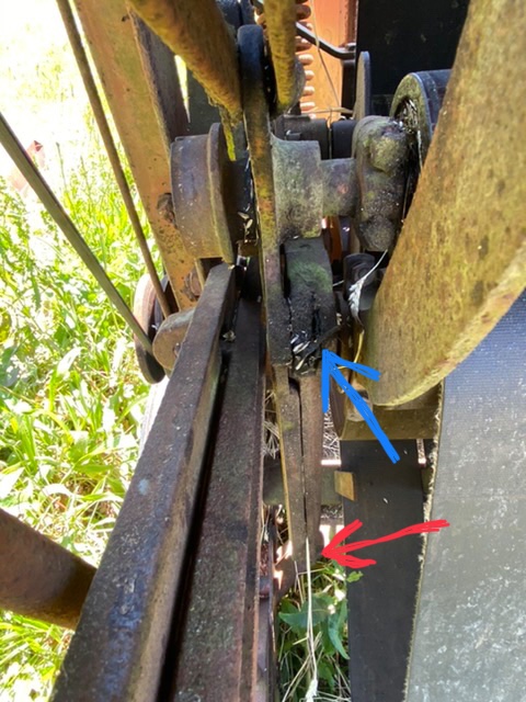

The blue arrow is pointing at the latch. The end pointing to the front of the baler moves up and down. To be latched it needs to be down as far as it can go.
The red arrow points at the end of the trip arms. If you can pull it back and separate the trip arms any amount, then the latch is not properly latched.

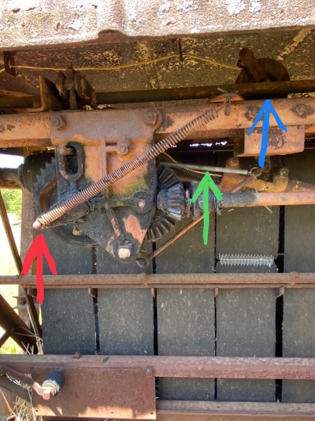

Post Options Post Options   Thanks (0) Thanks(0)   Quote NE GA Allis Quote  Post ReplyReply Direct Link To This Post Posted: 10 May 2020 at 2:36pm
On this photo,
Blue Arrow: twine tension discs
Green Arrow: spring that pulls the tension disc arm back to place. Just showing you this so you can verify that the spring is there and which direction it pulls on the arm.
Red Arrow: this is the cam that turns and lifts the trip latches to eject the bale. If this is always rotating, then the tension disc arm is not back in its place.
To my knowledge if you check in the two places I described, then I think you may find your problem. The timing for ejecting the bale starts when the press roller pulls the string in the baler and pulls on the tension disc arm, which allows the cam to turn and lift the trip latches. Hope this helps and some other members can verify this.

Looked at the baler again. According to the picture posted the green arrow shows a spring hooked to the rod and pulling back to the left. My baler has a spring hooked to that same rod on a cotter key and pulls to to right. Looks like a factory spring and factory mounting. Also have a triangle that pivots behind that rod and it has a hole in it like a spring would go into it.  Also have a rod to the left up behind the gears with a hole in it like a spring should go into it. In the picture is the spring shown hooked to this rod ? Should there be a spring going from the rod to the triangle however that does not look correct to me. Looks like the triangle should do something .

Hopefully someone with a white top baler can verify what you have. The photos I posted with the arrows are from a baler from the 50’s. It might be different.
Also it may help the others if you posted photos of the string mechanism you have.

Found a white top to look at.  I am missing the spring which pulls to the left. It is hookd to the triangle I talked about and then to the rod I talked about. Could very well be the cause of all my problems. Sure wish I could find OEM springs. Guess I will just try to match up a spring.
