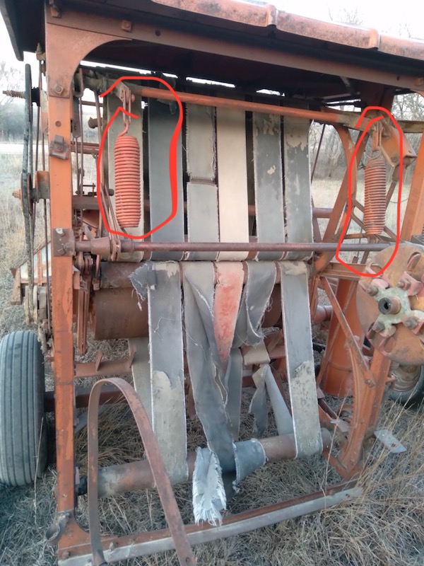

To be clear  are you referring to the two springs that hang on the upper rear of the baler that can be hooked and unhooked?
500592 View Drop Down
Joined: 12 Feb 2013
Location: USA
Points: 204
Post Options Post Options   Thanks (0) Thanks(0)   Quote 500592 Quote  Post ReplyReply Direct Link To This Post Posted: 31 May 2025 at 5:55am
Correct Gary I think dr.p is going to send me some unless we are thinking different springs…

Post Options Post Options   Thanks (0) Thanks(0)   Quote 500592 Quote  Post ReplyReply Direct Link To This Post Posted: 31 May 2025 at 6:03am
Joined: 12 Feb 2013
Location: USA
Points: 204
Post Options Post Options   Thanks (0) Thanks(0)   Quote 500592 Quote  Post ReplyReply Direct Link To This Post Posted: 31 May 2025 at 6:04am
Hopefully the picture came through I circled the springs in red.
Gary Burnett View Drop Down
Points: 3164
Post Options Post Options   Thanks (0) Thanks(0)   Quote Gary Burnett Quote  Post ReplyReply Direct Link To This Post Posted: 31 May 2025 at 6:38am
That is it,they need to be unhooked when the baler isn't in use.AC made a special tool to hook/unhook them but a claw hammer works fine.Also #1 thing on those balers is before EACH time you use it tap the side of the brake to make sure its not stuck,if its stuck when you start to make a bale it can do major damage.

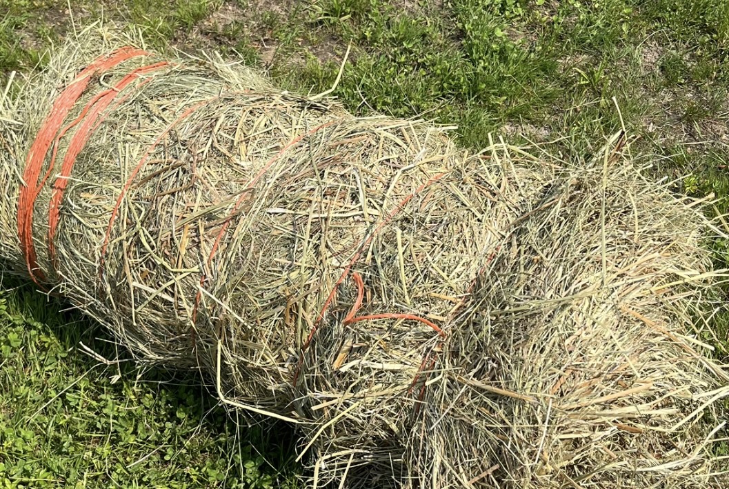

Big thanks to dr.p for sending em discharge springs and Gary agrisom on for the spring kit. Ran a couple old square bales through it and to my amazement it kicked a bale right out the back and reset to make another! I only had some plastic twine kicking around so I need to get some of the right stuff but it seemed to feed okay anyways.
The lower belts worked but are definitely ragged and should be changed. I have some from shoup does anyone have tips on getting those installed?
Just need to get a stretch of dry weather and I’m gonna mow a couple acres to really give it a test.

Post Options Post Options   Thanks (0) Thanks(0)   Quote dr p Quote  Post ReplyReply Direct Link To This Post Posted: 08 Jun 2025 at 8:19pm
Its great that did as much as it did, but when you get to "fine tuning", it shouldn't have that much string on one side of the bale
