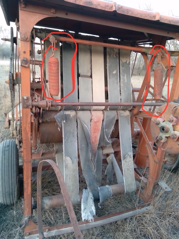

To be clear  are you referring to the two springs that hang on the upper rear of the baler that can be hooked and unhooked?

Post Options Post Options   Thanks (0) Thanks(0)   Quote 500592 Quote  Post ReplyReply Direct Link To This Post Posted: 31 May 2025 at 5:55am
Correct Gary I think dr.p is going to send me some unless we are thinking different springs…

Post Options Post Options   Thanks (0) Thanks(0)   Quote 500592 Quote  Post ReplyReply Direct Link To This Post Posted: 31 May 2025 at 6:03am
500592 View Drop Down
Joined: 12 Feb 2013
Location: USA
Points: 178
Post Options Post Options   Thanks (0) Thanks(0)   Quote 500592 Quote  Post ReplyReply Direct Link To This Post Posted: 31 May 2025 at 6:04am
Hopefully the picture came through I circled the springs in red.
Gary Burnett View Drop Down
Points: 3035
Post Options Post Options   Thanks (0) Thanks(0)   Quote Gary Burnett Quote  Post ReplyReply Direct Link To This Post Posted: 31 May 2025 at 6:38am
That is it,they need to be unhooked when the baler isn't in use.AC made a special tool to hook/unhook them but a claw hammer works fine.Also #1 thing on those balers is before EACH time you use it tap the side of the brake to make sure its not stuck,if its stuck when you start to make a bale it can do major damage.

We always unhooked them to relieve the tension so they didn't take the tension out of the springs,maybe not really necessary but doesn't hurt.The tool has a sort of hook on one end to unlock the latches and a round hoop like a handle on the other end.The balers had a bracket on the left rear to hold the hook.
