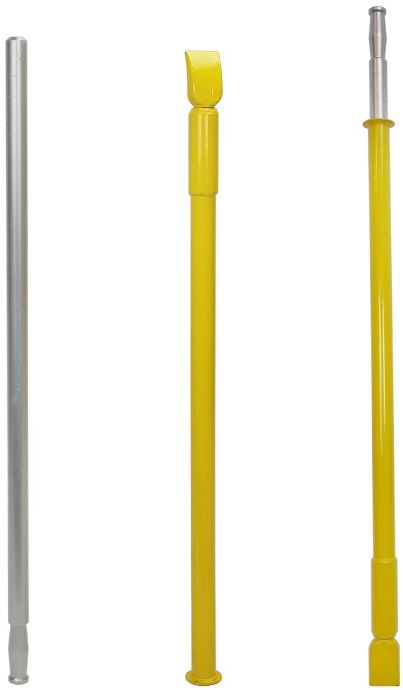

There's a tool made for breaking them down called a bead breaker. It's basically a slide hammer on steroids. It's about four feet long, has a real slick spoon. that you place against the tire at the bead area. Wait just a minute and I'll look them up and get back to you.

Oh does that bring back memories.... I worked in a heavy equipment shop back in the 80's. We used to break down truck tires. Our slide hammer/bead breaker was just a little different, it had a heavy sliding pipe on the outside. The ones shown above have a heavy rod inside the tool..... same principle, different execution....
If anybody is unclear how they work, here's an in-use pic.....
