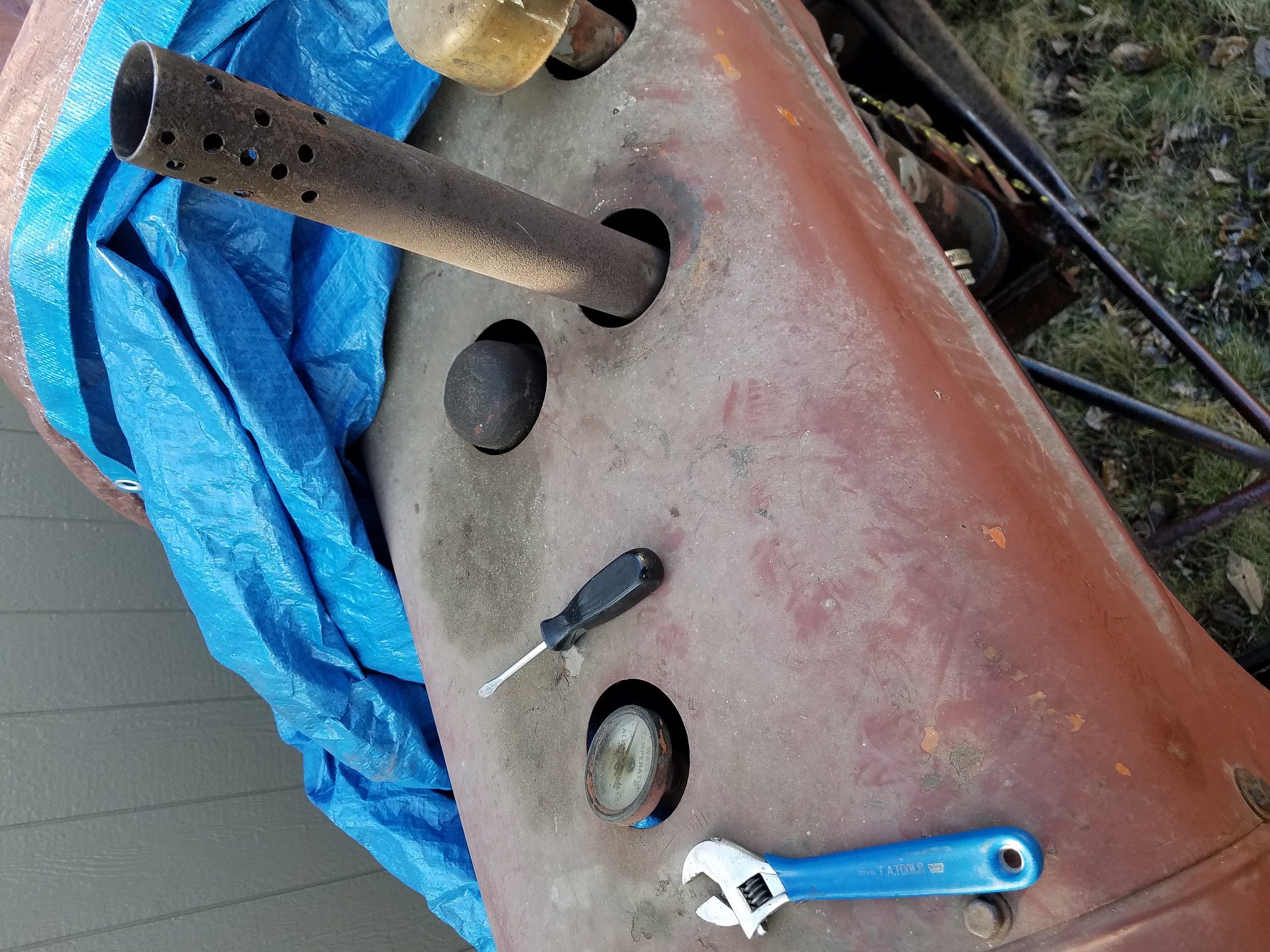

On another note, I noticed that there isn't a muffler, just this perforated pipe, which is fairly loose to the touch. Was this ever standard, or just a home job like I assume? What is the proper muffler style for a 1940?
The fuel line(rubber) is pretty stiff and cracked, so obviously that will be replaced. But right now it has an inline fuel filter(also needs replacing) but I have a fairly clean sediment bowl sitting on the shelf. Is there a significant advantage to the fuel filter? Assuming I get all loose garbage out of the tank and replace the seal on the cap. I would prefer the sediment bowl, because that was the original style. (Also if anyone has a picture of the original fuel line routing w/ sediment bowl, would be a big help)
