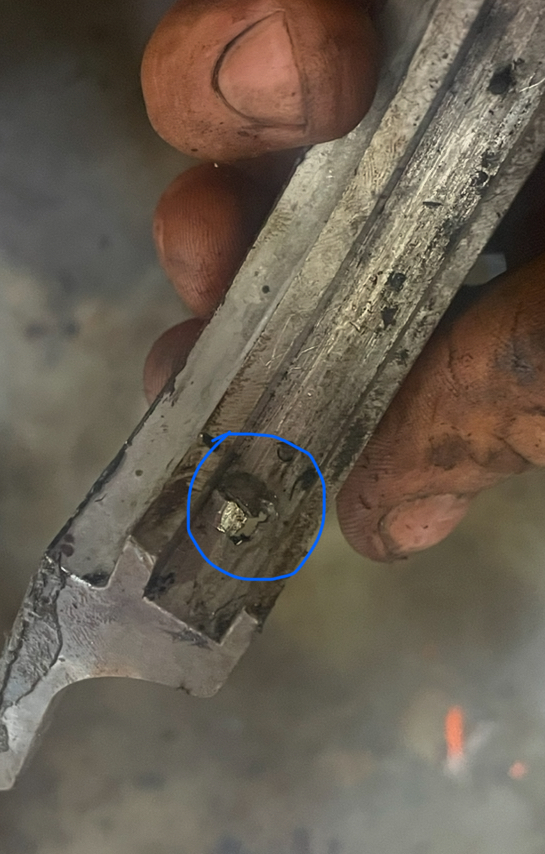

Post Options Post Options   Thanks (0) Thanks(0)   Quote 55allis Quote  Post ReplyReply Direct Link To This Post Posted: 25 Aug 2025 at 9:54pm
Here’s a picture of the rocker currently…
I never changed anything from when I pulled it off.
1955 AC WD45 diesel with D262 repower, 1949 AC WD45

Post Options Post Options   Thanks (0) Thanks(0)   Quote SteveM C/IL Quote  Post ReplyReply Direct Link To This Post Posted: 26 Aug 2025 at 11:05am
I can't tell from pic. Is head about 4in thick? Should be on a 17.
