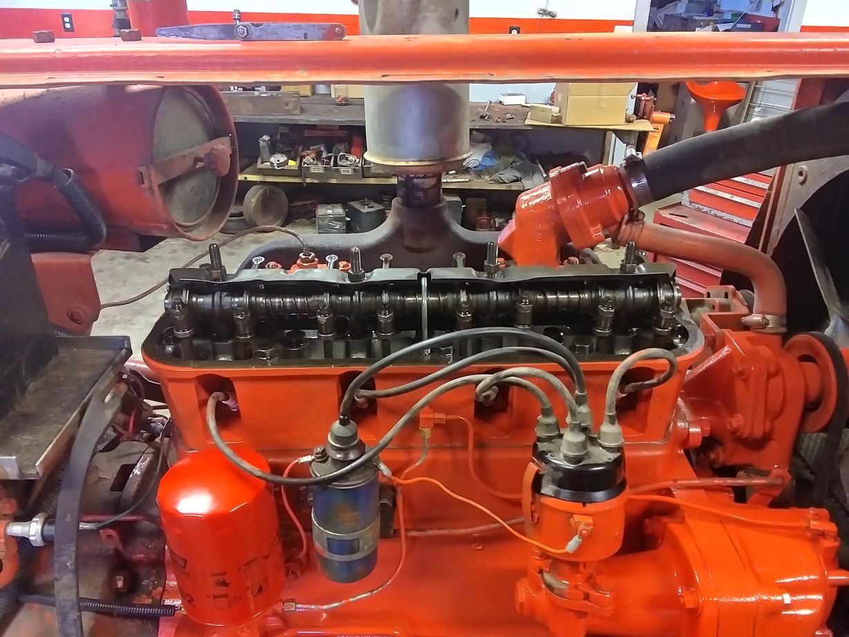

If the guides and caps aren't interfering and cam timing looks correct and guides weren't stuck about all that's left is rocker adjustment. So wait a minute...tall heads use short stands,short heads use tall stands...do we have short head short stands?

Post Options Post Options   Thanks (0) Thanks(0)   Quote 55allis Quote  Post ReplyReply Direct Link To This Post Posted: 25 Aug 2025 at 9:39am
Here is a picture before I removed it.
1955 AC WD45 diesel with D262 repower, 1949 AC WD45
Points: 21859
Post Options Post Options   Thanks (0) Thanks(0)   Quote DrAllis Quote  Post ReplyReply Direct Link To This Post Posted: 25 Aug 2025 at 10:00am
I wonder if he had the rocker arm stands upside down ?? Long side goes down to the cyl head.

Post Options Post Options   Thanks (0) Thanks(0)   Quote TedN Quote  Post ReplyReply Direct Link To This Post Posted: 25 Aug 2025 at 12:55pm
In that picture it looks like #4 intake is the only valve that is closed. I wasn't aware of two different pedestal heights that SteveM mentioned, but I was able to find a picture on Facebook of a D17 engine, and it looks like the pedestal mounts are about 1/2" taller. It also looks like there is a color change on the studs about 1/2" above the nuts in your picture, like maybe that is where the nuts used to be. I learn something new every day.

Post Options Post Options   Thanks (0) Thanks(0)   Quote Les Kerf Quote  Post ReplyReply Direct Link To This Post Posted: 25 Aug 2025 at 8:09pm
I believe that would do it Dead
Points: 8707
Post Options Post Options   Thanks (0) Thanks(0)   Quote Mikez Quote  Post ReplyReply Direct Link To This Post Posted: 25 Aug 2025 at 8:39pm
Yea looks like the rockers are just about up against tray.

Post Options Post Options   Thanks (0) Thanks(0)   Quote 55allis Quote  Post ReplyReply Direct Link To This Post Posted: 25 Aug 2025 at 9:54pm
Here’s a picture of the rocker currently…
I never changed anything from when I pulled it off.

Post Options Post Options   Thanks (0) Thanks(0)   Quote SteveM C/IL Quote  Post ReplyReply Direct Link To This Post Posted: 15 hours 43 minutes ago at 11:05am
I can't tell from pic. Is head about 4in thick? Should be on a 17.

Post Options Post Options   Thanks (0) Thanks(0)   Quote Les Kerf Quote  Post ReplyReply Direct Link To This Post Posted: 3 hours 37 minutes ago at 11:11pm
Originally posted by TedN TedN wrote:
... I wasn't aware of two different pedestal heights that SteveM mentioned, but I was able to find a picture on Facebook of a D17 engine, and it looks like the pedestal mounts are about 1/2" taller...
The only thing I have heard about regarding two different pedestal heights involves the early WD heads vs the later WD and the WD45 head; i.e. the 'Short' head and the 'Tall' head, which requires different pedestals.
According to three different online advertisements selling rocker pedestals for the D17 they measure 1.945" tall.

Post Options Post Options   Thanks (0) Thanks(0)   Quote TedN Quote  Post ReplyReply Direct Link To This Post Posted: 2 hours 10 minutes ago at 12:38am
Not sure how to do links but I was able to download the picture. Maybe I'm wrong, but it looks different to me. Keep in mind I don't have much familiarity with D17s, I am only going by what I see in the pictures.
