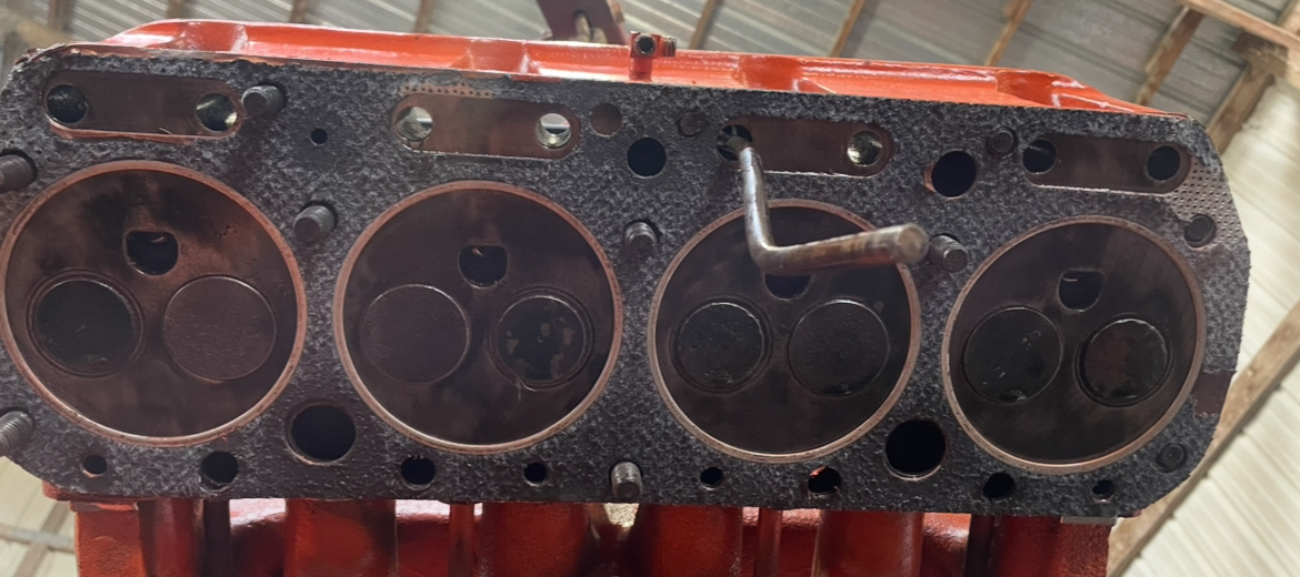

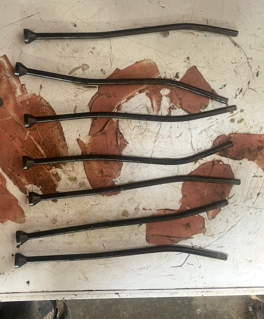

Update: found that all 8 push rods are bent and I call shot…
The rear crank seal leak ended up being the gasket had fell into the oil pan. ![]() ![]() ![]() Anything else I should check? I’m going to re-torque everything just to be safe. What are the common problems that cause pushrod bending? Don’t want it to do it again… |

In my case, the valves hung up in the head. Bent pushrods, bent valves, and left a mark in the piston where they made contact. Might even consider having the rods inspected as well.

hard to believe that EVERY VALVE was stuck.. but possible... I would check the CAM TIMING... that would effect ALL valves hitting the pistons.... checking the rods for any BEND would be a good idea.

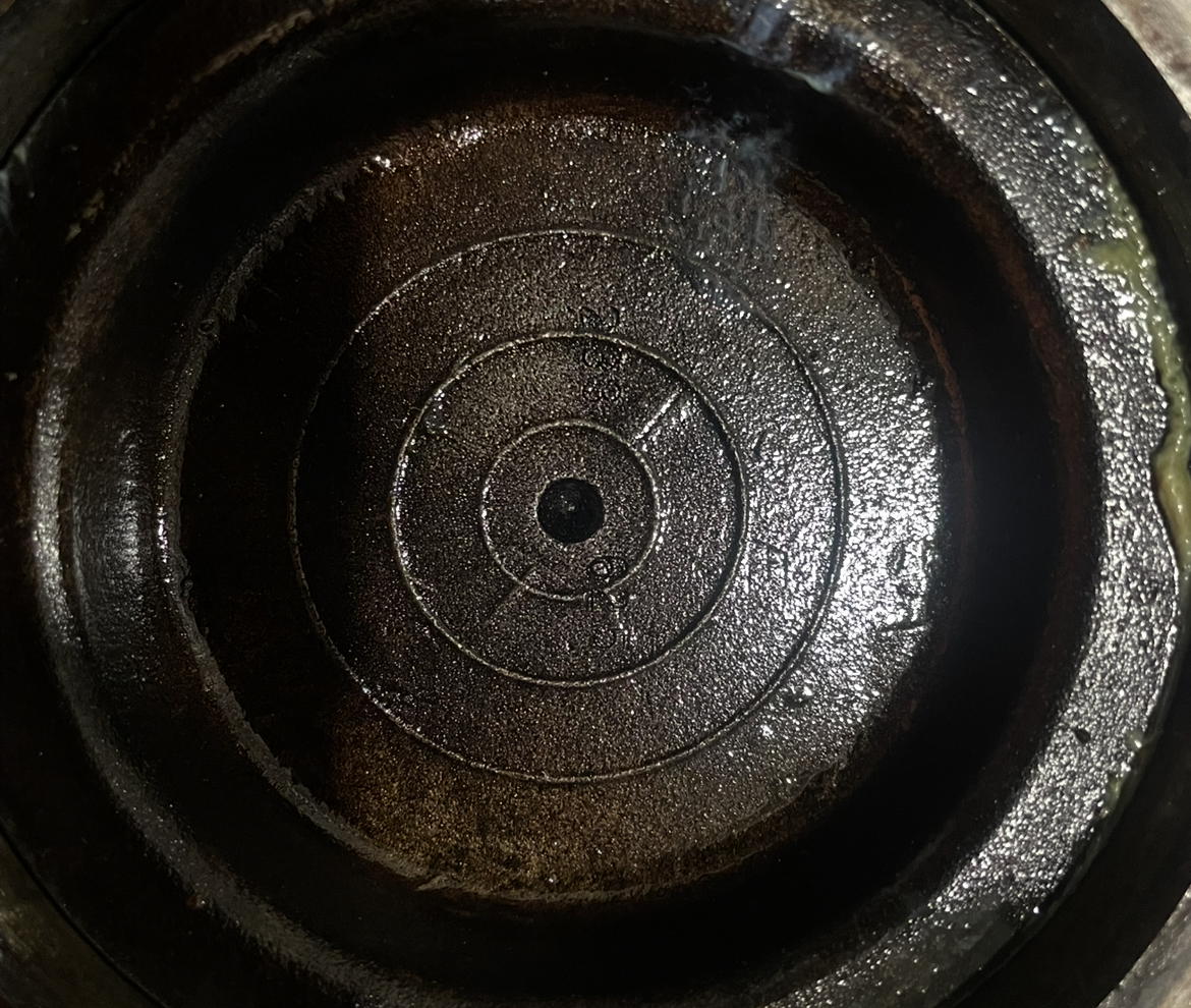

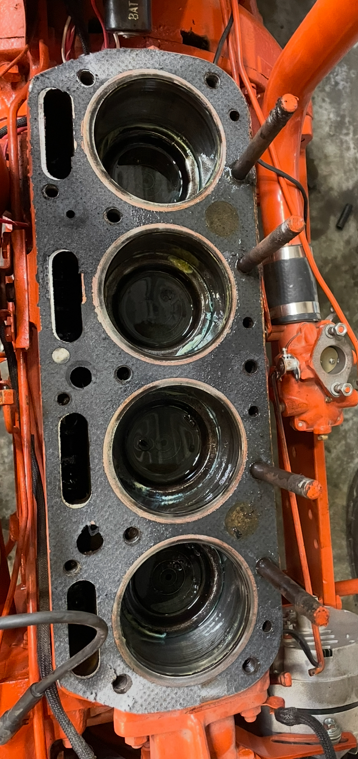

Funny thing is I don’t see any damage to the pistons or valves…

Found these numbers on on piston; AE 233
Maybe a brand and part number? |

There's something going on with that engine. It was a running engine !! That's why the rear seal was leaking...it RAN !! All 8 push rods bent on a running engine?? Makes you think the camshaft quit turning.

So now I’m even wondering if he ever had it running…
Spark plugs are new and never ran on (he claims put new ones after he ran it) Pistons still have grease on top. Crank pulley doesn’t have any paint/rust wore off from the belt. |

Would it still leave marks on the pistons if it was slowly getting turned over?
Like if someone tried to pull start it? Or is it just lucky and didn’t leave marks…. I’m just plump curious on why there is no marks anywhere that I can find. |

Makes me wonder if the push rods were even engaging the lifters.

Probably not. The valves come straight down in such a manner that the sharp edges will not cut into the piston unless the velocity is pretty high. Way back in my youth I did a ring and valve job on a Datsun 1600 cc overhead cam engine. In my ignorance I paid no attention to where the cam and crank phasing was and I just bolted the head on, then rotated the crank around to line up the timing marks. I felt a slight 'bump' of resistance while doing this but thought it was just the new rings dragging. Before I re-installed the engine I rotated it using a wrench, stuck my finger in the spark plug holes and found no compression on two cylinders. Yup, it bent the valves. Even though those valves contacted the pistons at an angle there were no discernible marks.

Check the valve guides. We had one do the same thing. The guides were not pressed down to specs and the result was the keepers were hitting the guides . Head shop misread the specs.
