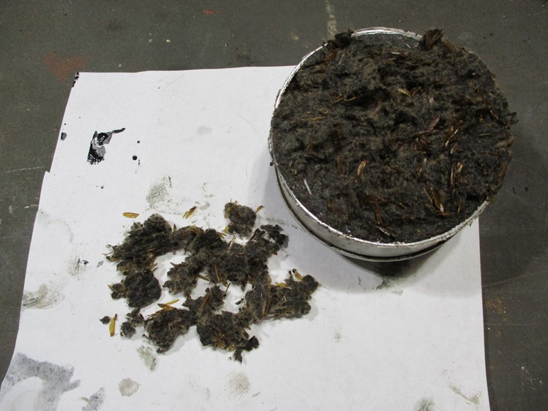

Post Options Post Options   Thanks (0) Thanks(0)   Quote steve(ill) Quote  Post ReplyReply Direct Link To This Post Posted: 4 hours 3 minutes ago at 3:42pm
I changed oil last week, so i went a grabbed the filter out of the trash. This filter probably has 100 hours on it over the last 2 years.. The filter was PACKED TIGHT with cotton fiber and a few cotton seeds. This is not CLOTH, this is raw cotton taken from the field that still has seeds in it.. Did not fall out of the can, packed so tight you have to pick it out with a screw driver. I ground up a hand full with my fingers and layed it on the table....This seems to be acceptable.. I doubt everyone is making these filters. I would bet there is one factory in India or China making thousands of theses and selling them to WIX, FRAM and BALDWIN.. who paint them and redistribute to NAPA, CAR Quest and Farm Stores with what ever "brand name" you want..
the guy in WFs movie says these are "rice seeds"..... i dont know.... but the "material" seems to be cotton like..
Edited by steve(ill) - 3 hours 58 minutes ago at 3:47pm

Post Options Post Options   Thanks (0) Thanks(0)   Quote AllisFreak MN Quote  Post ReplyReply Direct Link To This Post Posted: 45 minutes ago at 7:00pm
What brand did you cut open?
Points: 90043
Post Options Post Options   Thanks (0) Thanks(0)   Quote steve(ill) Quote  Post ReplyReply Direct Link To This Post Posted: 19 minutes ago at 7:26pm
NAPA 7011--- about 2 years old.. (Made by WIX).
