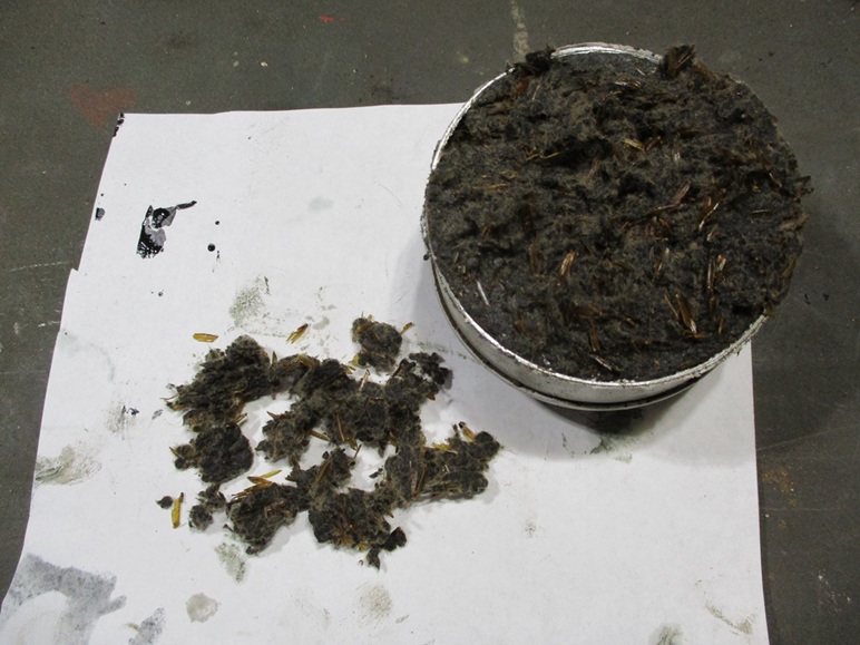

I changed oil last week, so i went a grabbed the filter out of the trash. This filter probably has 100 hours on it over the last 2 years.. The filter was PACKED TIGHT with cotton fiber and a few cotton seeds. This is not CLOTH, this is raw cotton taken from the field that still has seeds in it.. Did not fall out of the can, packed so tight you have to pick it out with a screw driver. I ground up a hand full with my fingers and layed it on the table....This seems to be acceptable.. I doubt everyone is making these filters. I would bet there is one factory in India or China making thousands of theses and selling them to WIX, FRAM and BALDWIN.. who paint them and redistribute to NAPA, CAR Quest and Farm Stores with what ever "brand name" you want..
the guy in WFs movie says these are "rice seeds"..... i dont know.... but the "material" seems to be cotton like..

with respect to the seeds in the filter... The filter is PACKED TIGHT with cotton.. This restricts the INLET pressure which is backed up toward the pump to 15 psi.. The OUTLET of the filter is zero as it dumps to sump... Only 15% of the total oil flow goes thru the filter, so it is MINIMAL flow. The seeds are basically TRAPPED into compacted material. I dont see any way for them to get out .  I have never seen a seed near the drain holes that are minimal diameter, or in the base, or in the oil pan.. You would never know the seeds were there unless you cut the filter open and pick thru the cotton.. Dont see this being a big problem.. Proobably been that way for years.......... the add above shows the filters being $11. at Auto Zone..... I think i looked on line 2 years ago and got the NAPA version for a similar price... No, im not paying $20. for a filter either... My opinion is they are all the same and just buy on PRICE when you need one.. Im only changing once every 2 years anyway.

on the  "NEW" filters that have the stuffed cotton and seeds, there is a 1/4 inch thick felt pad laying on the discharge plate, covering the holes... So nothing can get out.. Also the material is VERY TIGHT. The seeds are not moving around in the can or migrating toward the discharge.. I doubt the move at all from their original positon.. Like i said, i had to PICK the material out of the can with a screw driver.. Its very compressed..

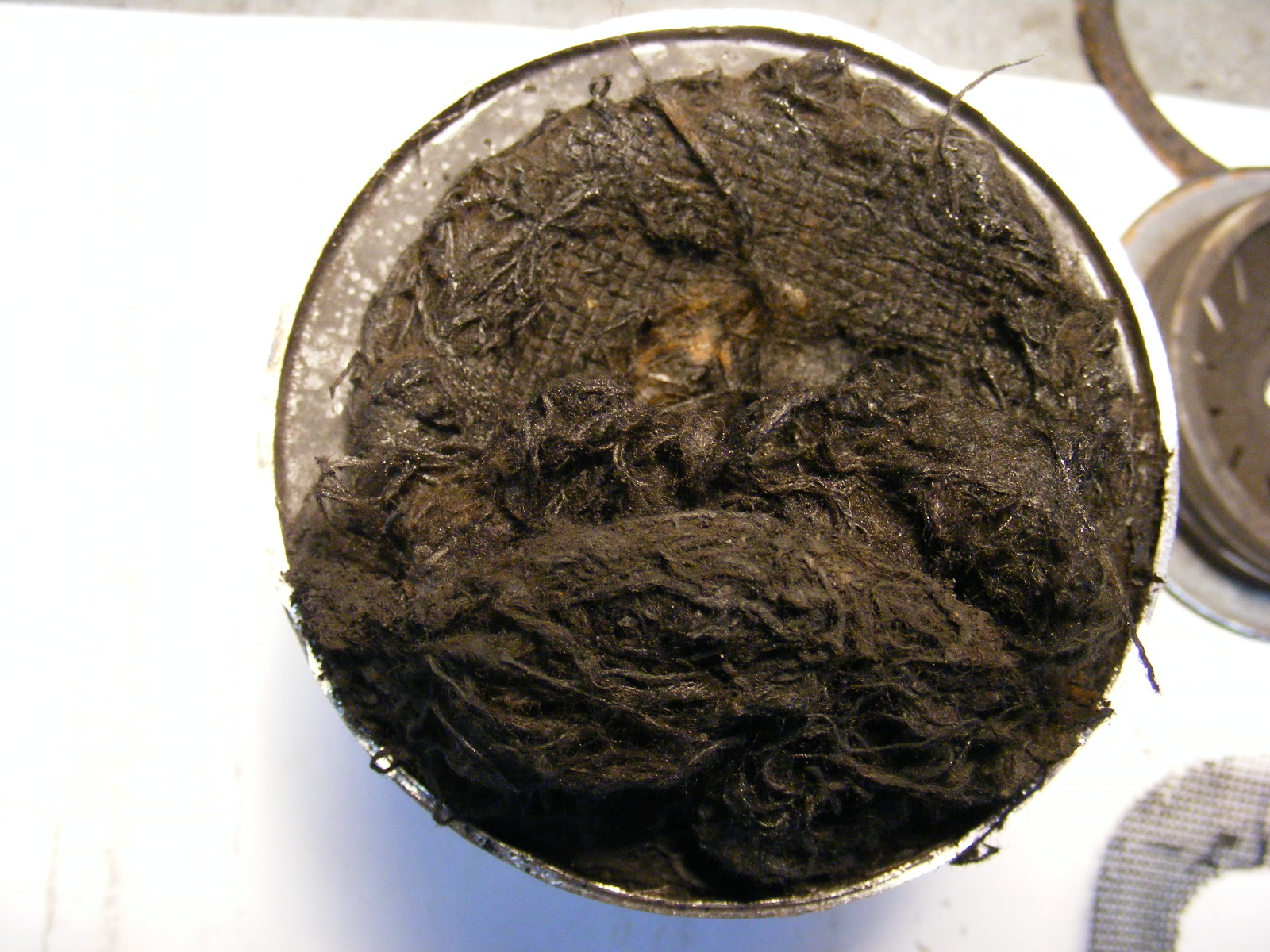

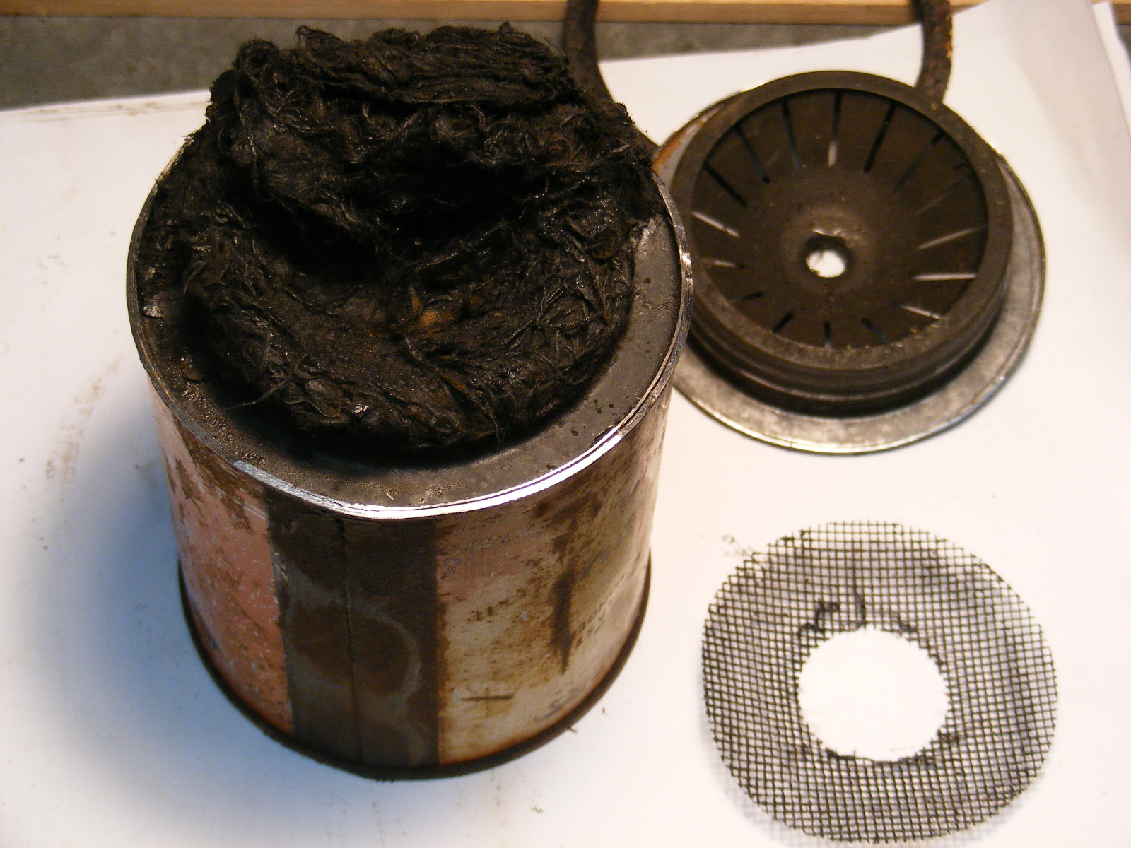

I opened up an old AC flat top filter today and it looks like its tightly packed with cotton string. On top of that is a piece of metal screen, then the threaded cover with the slotted metal dished piece in it.
