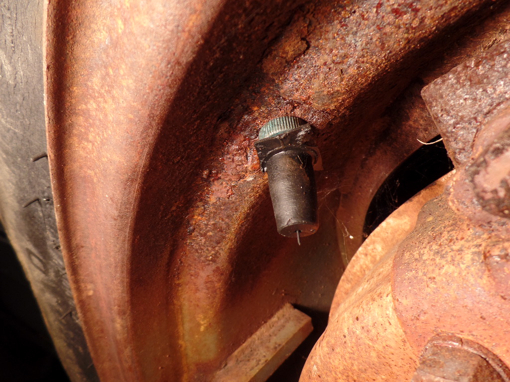

I have a feeling if I take this thing off to air up this tire which has calcium in it, I'm going to loose the air and the calcium.  Seems like I tried to take this off before and there was no core in the valve stem....can you put a core back in without loosing everything if that's the case?  Why would someone do this?

I spent 22 years in the tire business and replaced/repaired hundreds of rear farm tires and don't remember ever seeing anything like that. It looks like you need an old style core housing. It should screw right on where that unscrews.

[QUOTE=HD6GTOM] I spent 22 years in the tire business and replaced/repaired hundreds of rear farm tires and don't remember ever seeing anything like that. It looks like you need a new core housing. You can get them at TSC. New style has male threads, old style has female threads. It should screw right on where that unscrews.

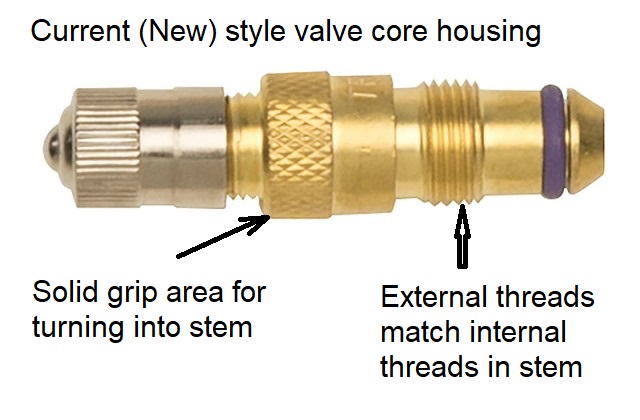

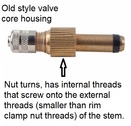

Post Options Post Options   Thanks (0) Thanks(0)   Quote Jim.ME Quote  Post ReplyReply Direct Link To This Post Posted: 24 Oct 2020 at 6:14am
Here are pictures of the Old and New (currently used) valve core housings.  You may want to have both on hand when you do this.
