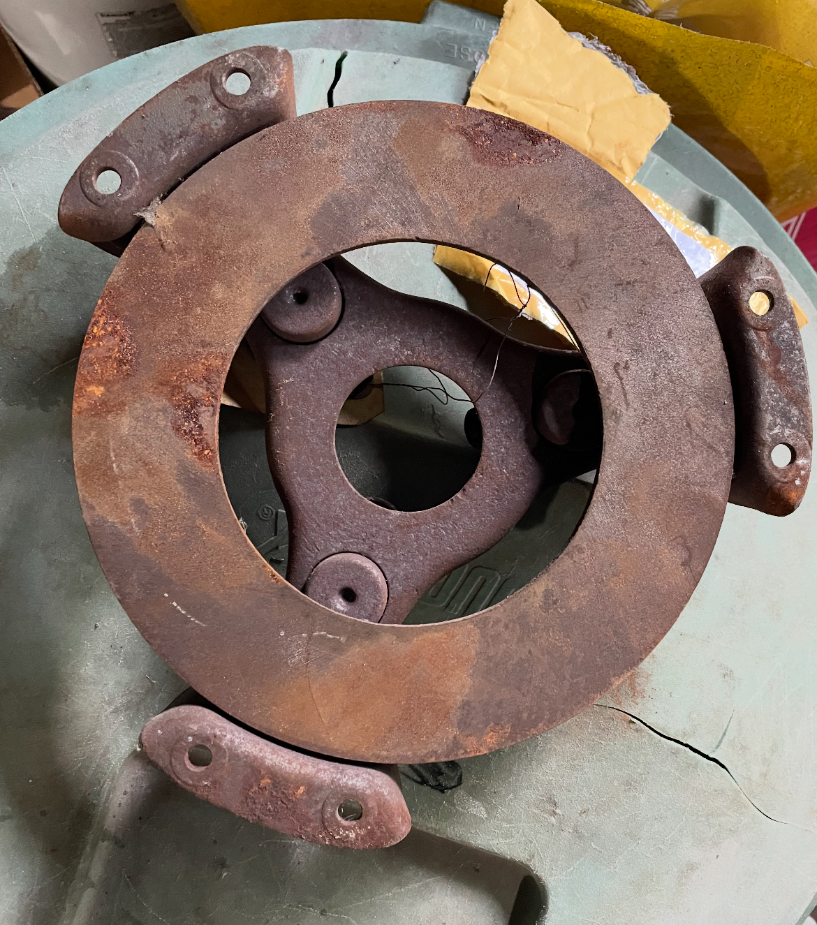

Post Options Post Options   Thanks (0) Thanks(0)   Quote 55allis Quote  Post ReplyReply Direct Link To This Post Posted: 06 Jun 2025 at 8:54am
Here is the RC one…

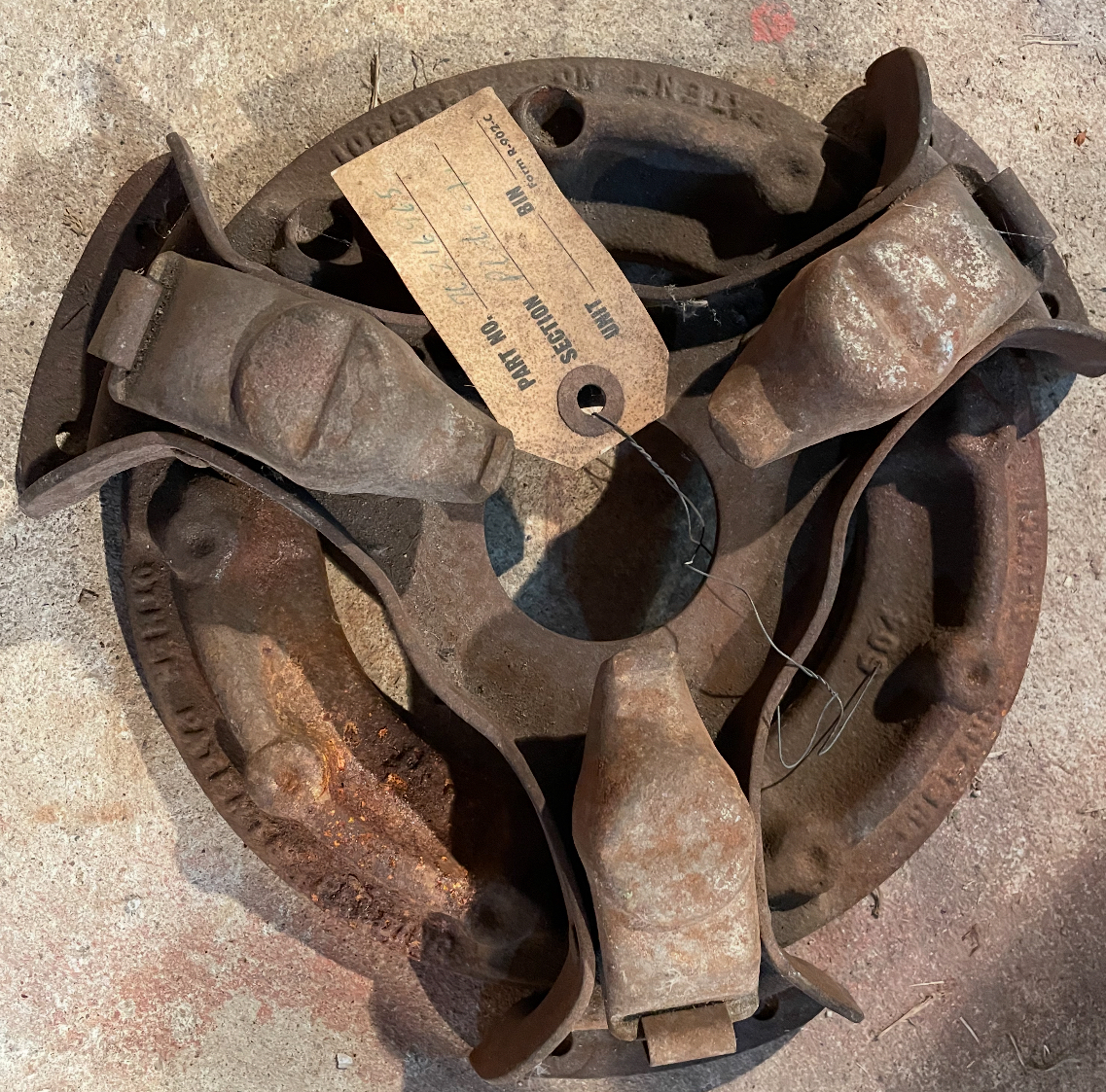

The part number on the tag comes up as a for a C….
Points: 5276
Post Options Post Options   Thanks (0) Thanks(0)   Quote PaulB Quote  Post ReplyReply Direct Link To This Post Posted: 06 Jun 2025 at 2:22pm
Is that number 70216965?  the parts book shows that number to be a Rockford pressure plate not the Auburn pressure you have pictured. What is the diameter of the driving surface?

Post Options Post Options   Thanks (0) Thanks(0)   Quote AaronSEIA Quote  Post ReplyReply Direct Link To This Post Posted: 07 Jun 2025 at 5:55am
Just remembered, no clutch plate will interchange without some work.  The RC used the smaller diameter B/C clutch, BUT used the WC spline center.  You'd need to rivet the WC splines onto a C plate.  Or find a clutch shop to redo your RC plate.

Post Options Post Options   Thanks (0) Thanks(0)   Quote 55allis Quote  Post ReplyReply Direct Link To This Post Posted: 07 Jun 2025 at 11:15pm
Think it’s a 9” but have to confirm..
Measured original on b125 and it is 8.5”
Original is absolutely shot due to rust.
Half of the springs are rusted through.
