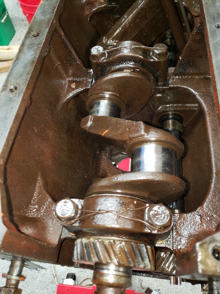

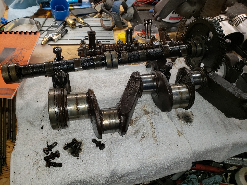

Update, I had time today to mount the engine block to the stand. Man I wish we had these things when I was younger maybe they did but I never heard of them. Anyway I was able to remove the crank caps mark them and remove the crank and the cam. sometime this week I will mic the journals' to see if they are in specs. The main journal surfaces look very smooth except where the oil groove is on the bearing that looks to be stained by something maybe water thinking emery cloth. I don't think I will be turning any wrenches this week because it is going to get very, very cold this week. But no big deal I have all winter to work on this project. A big thank you to Alex for reaching out to me with some misc. parts he has to offer. never knew there was a place only 30 minutes away from me who deals in old tractor parts.
Points: 8654
Post Options Post Options   Thanks (1) Thanks(1)   Quote SteveM C/IL Quote  Post ReplyReply Direct Link To This Post Posted: 08 Dec 2019 at 10:04pm
Always replace cam bearings on an old AC

Post Options Post Options   Thanks (0) Thanks(0)   Quote Sugarmaker Quote  Post ReplyReply Direct Link To This Post Posted: 09 Dec 2019 at 7:24am
Greg,
 That is looking like a Allis engine torn down! Clean up and inspection next. Your moving right along! Thanks for the update on your progress!

Post Options Post Options   Thanks (1) Thanks(1)   Quote DiyDave Quote  Post ReplyReply Direct Link To This Post Posted: 09 Dec 2019 at 7:37am
I wouldn't go with emory cloth, try some of those scotch-bright pads, finest you can get...Wink
