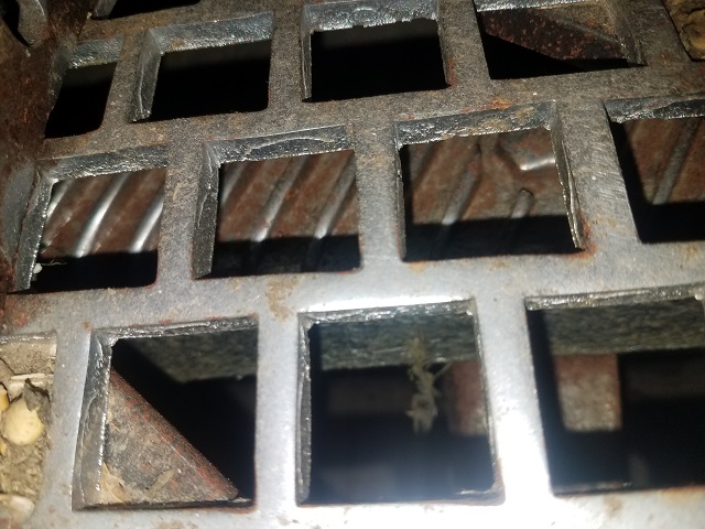

Post Options Post Options   Thanks (0) Thanks(0)   Quote Daehler Quote  Post ReplyReply Direct Link To This Post Posted: 08 Apr 2019 at 10:48pm
There are some photos. Some of parts that are being replaced. Sorry its been few months since i posted that many pictures. It still has the 516 motor in it, I think its just over 4400 hours. I suspect maybe an injector but I've heard about the deal with the Deutz. I might check the air intakes to see if anything has clogged them but dont think so. The filter only has 20 or 30 hours on it, and its cleaner than compared to how the R 50 would look with that many hours in beans. It started burning a little oil from the last owner and some people have said its normal for that motor to. I think I put two quarts in it after a 10 hour day this last fall. That seems execesive in my opinion.
Also the front feeder drum shaft has been pushed over to the left hand side and has beat up the stop blocks. I thougt the shaft was broke but it was when i pull it out. It was starting to round on one side and the block that the spring bolts go through are egged real bad. Could that be the problem? Havent checked to see if chain jumped sprocket up top yet, it looks to be running strait.

Post Options Post Options   Thanks (0) Thanks(0)   Quote Daehler Quote  Post ReplyReply Direct Link To This Post Posted: 17 Jun 2019 at 10:03pm
With the shaft and hole for tension bolt being worn, will it make the shaft be pushed to one side? Chain doesn't appear to have jump a sprocket when I crawled up in it.

Post Options Post Options   Thanks (0) Thanks(0)   Quote Daehler Quote  Post ReplyReply Direct Link To This Post Posted: 30 Oct 2019 at 12:25pm
Bringing this back up. After looking at the rotor bars, they look to be worn and have a round edge instead of being square. That must be a lot of my issue. Plus for some reason the overfeed auger has been taken out. It does have cylinder tailings return. Would not having that auger affect much? It doesn't make sense for already threshed crop be dropping back down to the feed chain. Want get the thing in shape for next year since it might be going over 4 to 500 acres.
