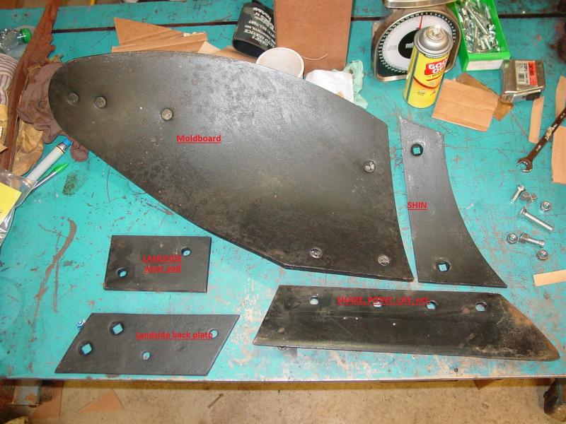

Larry in NC View Drop Down
Joined: 09 Feb 2016
Location: NC
Points: 1051
Post Options Post Options   Thanks (0) Thanks(0)   Quote Larry in NC Quote  Post ReplyReply Direct Link To This Post Posted: 18 Aug 2017 at 1:28pm
Tbone95 View Drop Down

Larry, for the most part I can't read the text...
So if that top curved thing (not shown in Larry's photo) is the coverboard, then what's the thing that goes on the top trailing edge of the moldboard?  (Also not shown in larry's photo)

K, opened Larry's photo in paint and can pretty much see what he wrote.  Yeah, I don't think any of this is what the OP asked about, except possibly the shin!

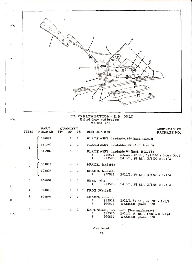

I can think of one more possibility:  "moldboard extensions" is what we called them when I was a kid.   They bolt onto the trailing edge of the moldboard in the two bolt holes shown on Larry's moldboard picture.  They help to make sure a ribbon of sod doesn't turn back over into the furrow when plowing certain types of heavy sod.  Sometimes this would happen when plowing sod that hadn't ever been plowed before  or hadn't been plowed in recent years.  I have them on my Snap Coupler plow but it's not here for me to take a picture of them.

Post Options Post Options   Thanks (0) Thanks(0)   Quote RickM(MO) Quote  Post ReplyReply Direct Link To This Post Posted: 18 Aug 2017 at 4:17pm
Here's a copy of the page from the Plow Bottoms Parts Catalog from the Farm Equipment - Knowledge Base Section showing the moldboard extension - Item 6:

Yes, Rick...that's what I remember, too...now that you mention it! LOL! Thanks!
