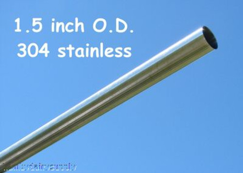

Joe, go get some old Stainless Steel 1 1/2" milk pipeline, maybe find it in some scrapyard in their stainless piles... That should really look 'PROFESSIONAL' when ol' Joe is done... Wait, I suppose you didn't have much in dairies out your way in the desert did you. well, guess that scraps that idea.Cry
Boy that would have looked good...
But at $152.00 for the 1.5 INCH x 20 FT SS MILK/WASH TUBING seems kind of expensive... to bad if you can't find some in a scrap yard. I have some 10' glass... be kinda hard to weld...Wink
