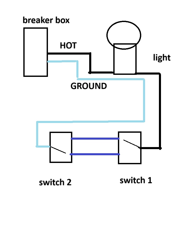

normally the power goes thru the switches, then to the light... It is possible to run the power to the LIGHT and then the white wire thru the switches, and back to the box as the ground... see if i can draw a picture.. Not saying this is what you have, but sounds like it..
the BLACK wire from the breaker box goes to the light.. the white wire passes thru the light box, not connected to anything... The light feeds the power side of the first switch.... the two switch terminals on each switch are connected as normal ( the blue wires-- these could be any color in reality).... then the WHITE wire comes off the second switch HOT SIDE and runs back to the breaker box to complete the NEUTRAL side of the circuit..
EDIT... the drawing should say NEUTRAL for the white wire.. not GROUND..
Edited by steve(ill) - 14 Oct 2025 at 10:15pm

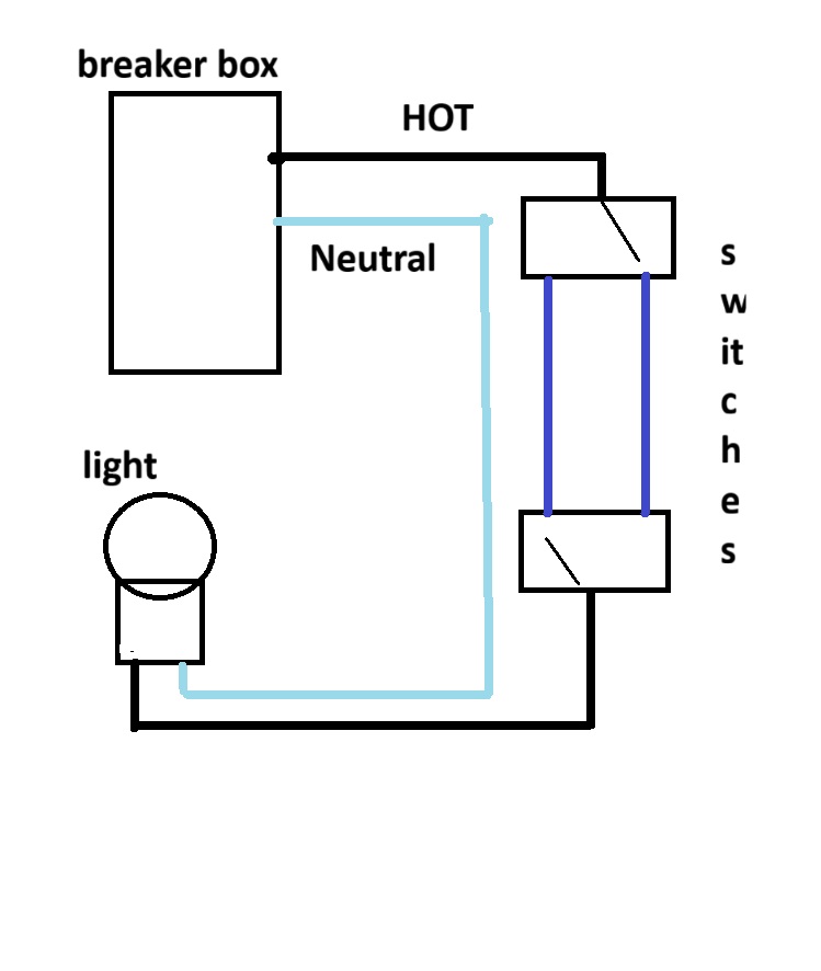

normally the light box would have ONE Romex wire inside... Black inlet and white neutral.. one on each terminal..( see below)... If you have TWO ROMEX wires, and the whites are connected together, and NOT on the light terminals..and you have a BLACK WIRE on both light terminals... then you might have the above drawing.
