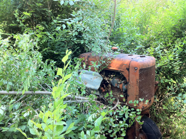

My father in law has owned a C since, I guess, the 1970s.  One of  his dad's friends gave it to him back then - he'd bought it new in 1948, used it for years and finally just parked it in the early '70s.
It's been parked at a friends place for at least ten or twelve years - long enough to turn into part of the "landscaping"!

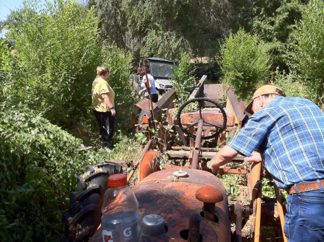

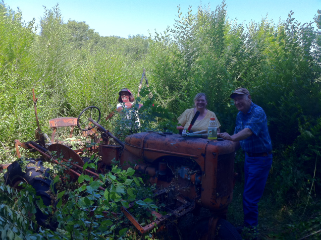

After some vicious weed-whacking, we mostly cleared it out.
(That's my sister, my wife and my father in law)

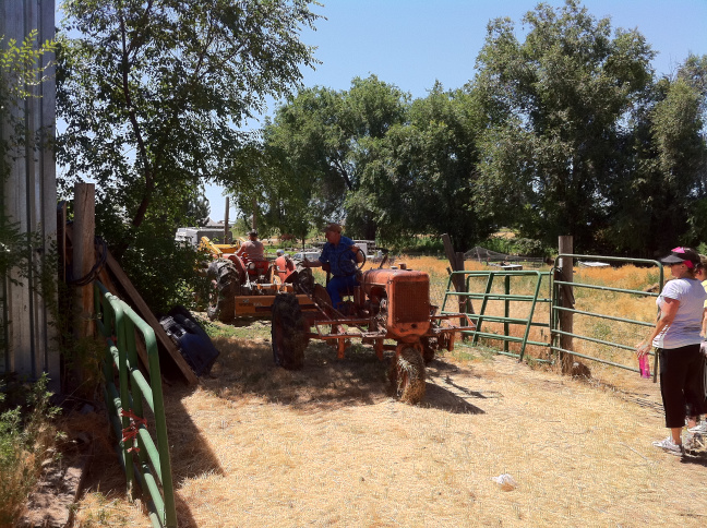

And, guess what, we found a manure spreader that nobody remembered!
Hooked it up and hauled it out!

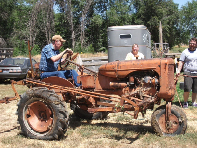

After all that time, it had sunk about 6 inches into the dirt, but the tires still has at least some air in them.  Unfortunately, the engine is frozen and the manifold is cracked.  So my father in law is tearing it down and this winter, we'll rebuild the engine and repair or replace whatever needs fixing.
But...there's one thing that's driving us nuts!  We can't figure out how to disassemble the lever and rod that go through the right side of the radiator shroud to control the shutters in front of the radiator.  The lever and rod have to come out before the shroud can come off.  We've got the I&T manual and a parts manual, but neither of us can see quite how to take that doggone thing apart.  Can anybody help?

To remove the crank assembly for the radiator shutters, you
turn it all the way counter-clockwise or anti-clockwise, and then
it should unscrew, but it is probably rusted stuck. Can you shoot
some penetrating oil through the grille mesh onto it? That might
help. if you could get some heat on it from a torch, that is
most likely what you will end up doing, but be careful to keep
all of the heat away from the radiator, as brass fins and solder
melt really fast. HTH

great looking C have fun with it. If you look up through the grille screen, there is a spring that clips over a pin (look at Dick's picture) remove the spring and the rod end of the crank can be unhooked and the crank can be removed. Bob
