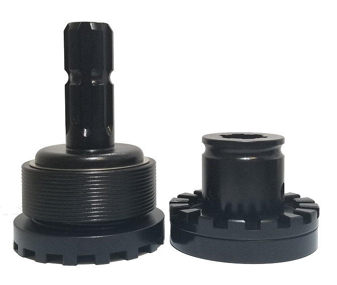

Hello guys, this old man needs some help. I start having some issue connecting the pto shaft to the tractor, I just don't have the strength in my arms and back like I once did.
I have been looking online for something to help and came across this thing call Pto Connect. it seems like it would help but I would like to get some advice before I commit to it.

The chief problem I see with all of these adapters is that you might have to cut down the drive line, to make the shaft a little shorter.  Also, when installing any type of these adapters, make sure to apply never-seize compound to both ends, to keep the adapter from rusting to the shafts...

As mentioned these adapters may not work with some drive shafts due to shortening the distance between the PTO attachment and the implement.

Along with the other things already mentioned, you will be adding weight to the shaft when you install the adapter piece, it doesn't replace the coupler you have on your shaft(s) now. And you still have to slide the collar to lock it on or remove it. If you have button type locks now, you can get replacement collar lock type yokes. That would be lighter than adding an adapter to your shaft. Cleanliness and proper lubrication of the shaft/coupler goes a long way to how easy a PTO shaft hooks up.
