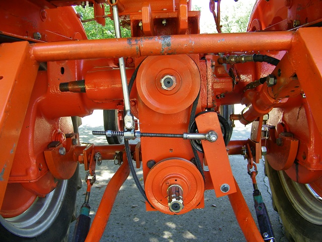

Update:  decided to use a belt drive with a tension idler,  mowed some with it today and worked pretty good.  Got some pics, if you're interested just drop by and I'll share pics,, or just maybe give a short look see.  In other words my smarter than me phone won't give up the pics.......I'll try the camera tomorrow........

Post Options Post Options   Thanks (0) Thanks(0)   Quote TMiller/NC Quote  Post ReplyReply Direct Link To This Post Posted: 26 May 2020 at 9:07pm
Finally a pic,,,,whew!!!!!   Keep in mind this is before  clean up and paint...

Post Options Post Options   Thanks (0) Thanks(0)   Quote MACK Quote  Post ReplyReply Direct Link To This Post Posted: 26 May 2020 at 9:58pm
That should work. Better than getting pushed in a pond.       MACK

Post Options Post Options   Thanks (0) Thanks(0)   Quote Dave(inMA) Quote  Post ReplyReply Direct Link To This Post Posted: 27 May 2020 at 9:49pm
Very clever. Any chance you could post a couple more photos to show the tensioner "closed" and the linkage from the operator's seat? Thanks.

Post Options Post Options   Thanks (0) Thanks(0)   Quote ac fleet Quote  Post ReplyReply Direct Link To This Post Posted: 28 May 2020 at 11:08am
Well----That should work! actually it looks great and if you have mowed with it and it holds----YA got it whipped! GREAT idea and GREAT job on it!

Post Options Post Options   Thanks (0) Thanks(0)   Quote Brian F(IL) Quote  Post ReplyReply Direct Link To This Post Posted: 28 May 2020 at 1:47pm
Tim, I must say, that is an ingenious way to overcome the obstacle of getting away from the blades turning when you engage the PTO.  I'm interested in seeing how you "beefed up" the apparatus you constructed.

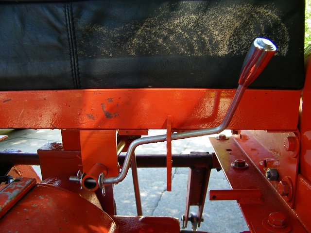

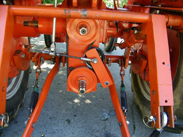

a couple of pics of pto belt drive
 1st pic operating lever in off
2nd pic lever engaged
rear view engaged

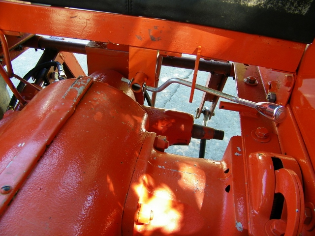

Post Options Post Options   Thanks (0) Thanks(0)   Quote TMiller/NC Quote  Post ReplyReply Direct Link To This Post Posted: 30 May 2020 at 6:33pm
disengaged
linkage under seat

Post Options Post Options   Thanks (0) Thanks(0)   Quote Dave(inMA) Quote  Post ReplyReply Direct Link To This Post Posted: 30 May 2020 at 9:09pm
Very slick! Thanks for the pictures. The creativity on here never ceases to amaze me.

Post Options Post Options   Thanks (0) Thanks(0)   Quote TMiller/NC Quote  Post ReplyReply Direct Link To This Post Posted: 30 May 2020 at 9:35pm
I think the shift "knob" is from a 46 chevy, came from some things of my Dads.
