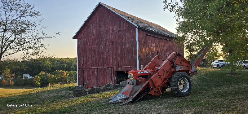

I currently have a 150 picker on a D15....
Runs GREAT looks Fantastic!
It was showroom clean when i bought it...
Although i had to some tin work repair. Not from rust, from phisical damage not rust....
Also had lots of mechanical adjustments to do as it had never picked corn on this "RESTORED" tractor....
Anyway to this day i have NOT picked corn with it..
It is to clan and beautiful to dirty up, so i still pick by HAND....

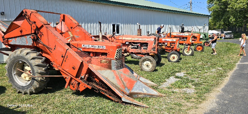

The tractors in the picture with the mounted corn picker- they don't have any side curtains
