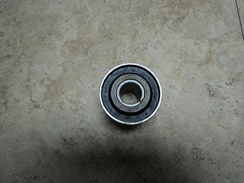

Here is a picture of the round shaft bearing
It is 3" in diameter; center hole is 1" in diameter; the bearing is 2.5" tall.
Another view.  These are the type I got from Larry.

Originally posted by Brian F(IL) Brian F(IL) wrote:
... find some NOS; check with Larry Swenson.  ...
We're getting closer! Big smile
What's "NOS" and where do I find this Mr Swenson? Your've looks the same except for the round bore.

Date Posted: 27 Mar 2016 at 8:06pm
the bearing is ROUND the center here is a hex inner sleeve. Press the inner sleeve out, then the bearing and replace as in the 70330133. Less than $100 to put/press in 2 brgs. Save one spacer to put between the 2 new brgs add a flat washer on each side as a dirt shield. Will last years..
