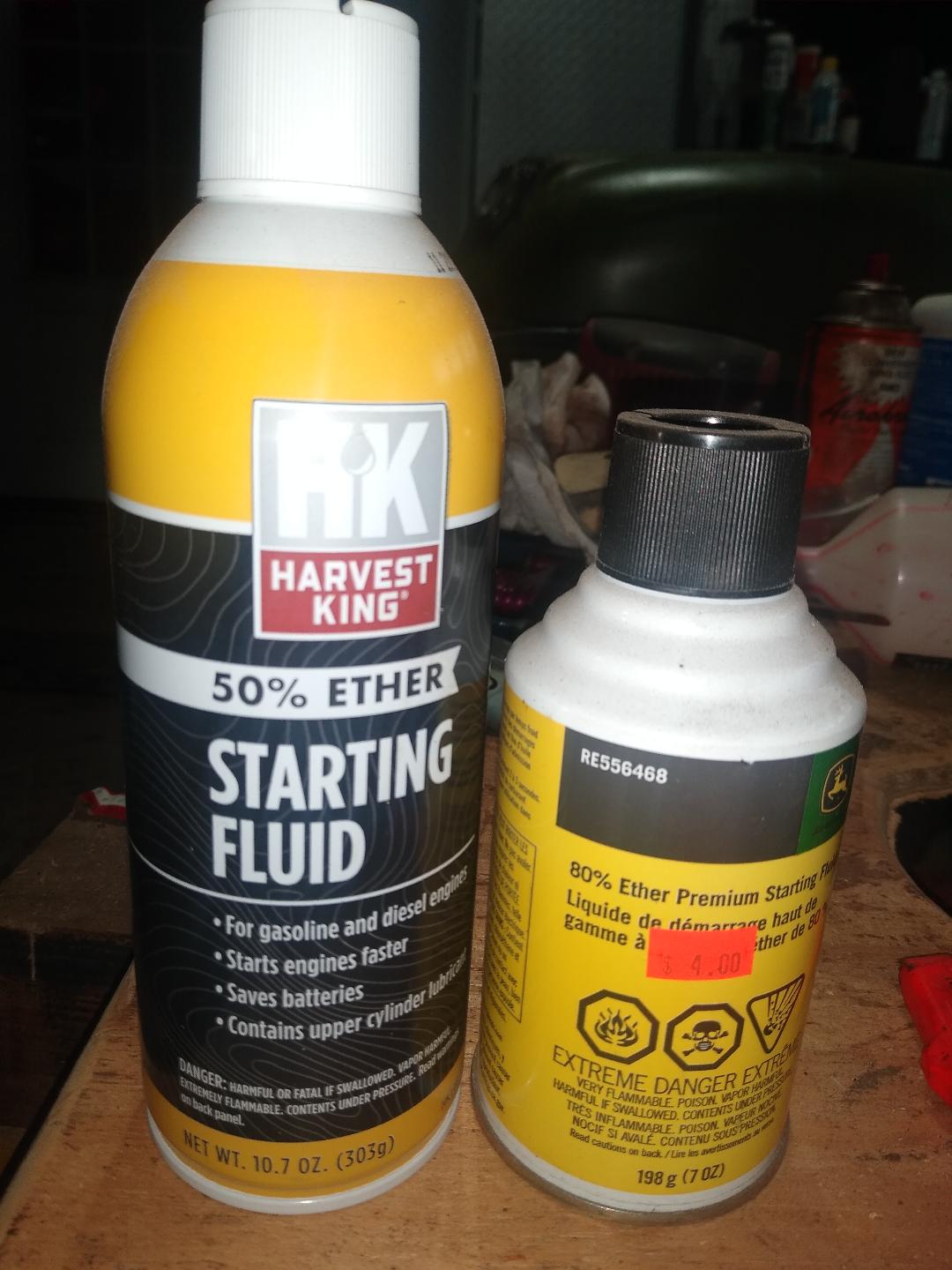

Posted By: WF owner
Date Posted: 19 Jan 2023 at 9:37pm
One of the things no one has spoken about is the starting fluid. I don't know why, but when I do have to use starting fluid, I find John Deere starting fluid is much better than any other brand. Am I getting senile or is there a difference?
Posted By: Les Kerf
Date Posted: 19 Jan 2023 at 9:42pm
No doubt it is better but I am a tightwad and buy the cheapo Walmart stuff. A can of it lasts a long time.

Posted By: WF owner
Date Posted: 20 Jan 2023 at 7:46pm
Here's a photo of the two kinds of starting fluid I had on hand.
