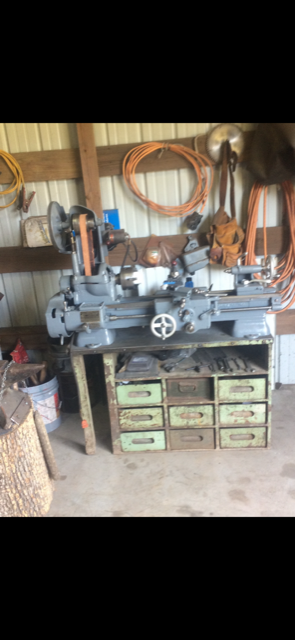

Any photos of the Mill, this style machine had a reversable head support system that allowed use of Adaptors out of the drive hub or for supported arbor style work.
Posted By: Thad in AR.
Date Posted: 23 Dec 2022 at 12:29pm
one more try

Posted By: DaveKamp
Date Posted: 23 Dec 2022 at 9:02pm
Originally posted by Walker Walker wrote:
Your spindle has to be open or won't be able to knock tapered holders out. Oh yeah and B and S tapers are hard to find for some reason used. Collets run large monies.
This isn't true.  If the spindle is blind, there will be a window in the side into which a release wedge can be driven.
Collets are pretty much standard-fare, and one does NOT need set-screws to keep an end mill securely in the collet, it's surface gripping force is several orders-of-magnitude greater than a half-dozen setscrews could ever impose, AND it provides a stable support axis which setscrews can not.
The B&S #9 was a common taper used for many of the small B&S mills, as well as many Moore spindles, and one of the most common on Bridgeport type 'M' vertical heads.
Yes, the #2 Morse WITH DRAWBAR was a more popular fixture for the M-vertical, particularly in metalworking shops, but the J-head's R8 tooling superceded the M anyway.
The B&S Horizontal, when fitted for pocket milling, used just the taper to hold the milling cutter in place.  IF you load the cutter too heavily, it will break off before disengaging from the taper.  IF the taper releases, it is because the spindle ID taper has been damaged, or the mill collet's taper has been damaged, or both.
Drawbars are more common on post 1920's machines, where pocket milling into iron and steel was much more common.  Prior to 1920, use of a SMALL horizontal mill for pocket milling was most often for cabinetmaking, patternmaking out of wood, or light machining of soft (copper and brass) mechanisms like door latches.
If one needed a more substantial pocket into irons or steels, one used a Horizontal Boring Mill, as it had a much more substantial chassis and drivetrain.
Posted By: Walker
Date Posted: 23 Dec 2022 at 9:07pm
That looks like one of the pre dirt models.
Posted By: DaveKamp
Date Posted: 23 Dec 2022 at 9:09pm
That is from 1895ish through 1920 or so.  They were typically driven from overhead lineshaft.  The table feed was driven by belt from spindle down tot he cone sheave on back.
BTW, that looks like a B&S #0 Plain, if so, it will probalby have a B&S 9 taper with a 17/32" through hole.
The overarm retains the arbor.  Inserting the factory 'knock out' rod through from the back should release the taper, but don't be surprised if it isn't ready- the precision on that taper is incredible, and a few years will make them really wanna stay.
To get the drawbar taper released on my Milwaukee #2 horizontal, I had to insert the knockout rod, and whack it.
Here's a ref on PM for it:
https://www.practicalmachinist.com/forum/threads/brown-and-sharpe-no-0-plain-horizontal-mill.357255/" rel="nofollow - https://www.practicalmachinist.com/forum/threads/brown-and-sharpe-no-0-plain-horizontal-mill.357255/
The trick to releasing, is not to use a big hammer, use the smallest, and swing it as FAST as you can- it is shock that releases, not thrust.

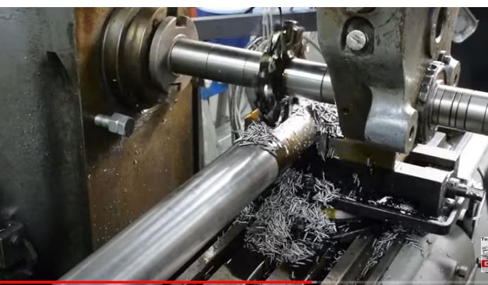

Posted By: B26240
Date Posted: 24 Dec 2022 at 2:38pm
If you guys want to watch a B&S mill (1895ish) cut a spur gear go to    " Old steam powered machine shop video 72"   Video 71 Dave R shows replacing the lathe type center in the overarm support with a running bushing.   Vid 72 Dave cuts the gear with mill powered by steam.
I just watches video 71 and will watch 72 tomorrow. Excellent video thanks for the info. That place is amazing.
Date Posted: 25 Dec 2022 at 9:48am
My lathe and drill press
