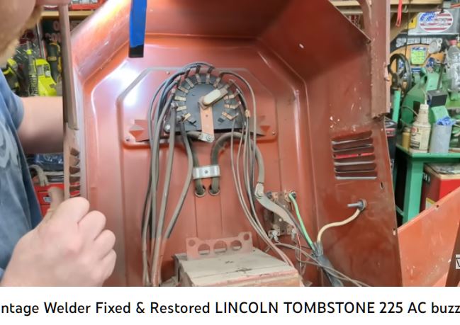

 Well, it sure lookin like ole TBone and Steve and the other Steve have just about narrowed down to it being the friggin Lincoln machine,,,,
 I got my Multitestor and checked the legs on the 220 going to the work area and got 120 VAC on each leg,,same for the actual plug. Even plugged in an extra 3 prong dryer plug into that outlet and read those ends and also gots 120 VAC on both legs,,,,,   SO,, I moved that Old Timer machine into garage,,It is FRIGGIN COLD in these parts these days,,was and STILL IS 17° with no wind,,,!! anyway, I wired up the Dryer plug into the machine,,used a 3/32 7014 rod with machine set at 70 amps and,,,,and,,,that sob took off like an old "Hot Rod Lincoln". Just as purdy as you please!!! Chit that 7014 ran so purdy,,,can't hardly believe it!!  SO,,,me being JOE, I took a stick of that 7014 and turned on the Lincoln and that sob failed miserably!!! It stuck,,  Pharted ,, slid around  missed,,,!!
 OK,,,,,what could be wrong with The Lincoln???? I removed the cover and checked the volts right at the switch and is getting the full 220 VAC,,,,,,?????

Posted By: steve(ill)
Date Posted: 22 Dec 2022 at 8:56pm
i would look at all the bolted faces and contacts on the switch..  may be corrosion BETWEEN them that you cant seek.. Look for small indications of pitting on the contacts. Loosen all contacts, sand paper / shine and reinstall / torque.
Looks like the wires are HARD WIRED to the transformer.. Only place for pitting / corrosion is on the switch contacts and the main lead for stinger / ground..
yes... dont look too close at the power switch... This guy has the green (ground)  and white (hot) wires mixed up !!

Posted By: desertjoe
Date Posted: 23 Dec 2022 at 4:20am

I just GOOGLED "Lincoln AC225 welder" to start with... You get a lot of info  / sales / data...
Then i went to YOU TUBE and typed in "Lincoln AC225 welder" ... and you get a list of how to REPAIR / UPGRADE / RESTORE... etc.... then look at a couple that SOUND GOOD to see if you can find what you want.
here is another......
https://www.youtube.com/watch?v=5bMyUlI_xIo" rel="nofollow - https://www.youtube.com/watch?v=5bMyUlI_xIo

It sounds like there could be some shorted windings in the secondary side of the transformer. A welder transformer is way more complex than a simple step down transformer. The secondary has inductive reactance built in, often called a reactor. It's purpose is to keep the amperage constant by varying the voltage by varying of the magnetic field in that part of the transformer. Without the reactor, it would be like trying to strike an arc using a 12 volt car battery, jumper cables, and a welding rod.
Posted By: jaybmiller
Date Posted: 23 Dec 2022 at 3:20pm
With power off (had to say that...jes in case....)
open it up and  clean the contacts of the 'amps selector'.
yes I KNOW the movable one is 'fun', I used a thin ,very fine file for that...
when it 'gave up the ghost' I got a new switch and WOW, machine was like new again....

The Lincoln AC225 is probably the most common welder on the planet, and I own one, used the heck out of it for decades before getting my paws on the Miller SRH-333 and CP200... but with probably 12 welders now in my immediate fleet, the AC225 is STILL here, because my grandfather gave it to me.
The problem you're having is clearly a matter of resistance in the cabling somewhere.  It could be at the cable connection terminal (inside the unit) or at the ground clamp and stinger connections, OR... if there's a cut in the wire in the middle, it could have a rotten spot in the copper somewhere inside that wire somewhere.
Grab a wire, nearest the unit, bend it with two hands.  Move away by an inch, bend it again.  Keep flexing it 'till you get to the other end.  Repeat with the OTHER cable.
If you EVER feel any spot that feels 'crunchy', cut it open with a knife, and let all the fuzzy green powder out.  Then remove the cover, disconnect the old cable, thread in new cable, connect it, seal it, tape it, seal it again...  then reinstall the ground and stinger clamps (make sure the AC polarity is set right ;-)  )  and then clamp in a fresh rod and try again.
The "AC Polarity" joke is is an elbow-ribbing to all those who suggested Joe check the polarity of his AC-225.  Those of us who weld lots are very sensitive to our polarity when using AC.

 My original , 1987ish..AC-225-S is HARD WIRED...does NOT have  'slide in connectors' nor does my spare unit or the one in the picture 2-3 posts up.
DJ if yours DOES have 'slide ins', you'll need to buy PROPER ends ( 4 pieces) to repair it OR properly modify your cables to bolt on. I have spare cables here but no passport.
A couple of pictures would really help !  I KNOW the parts ARE available.

...I DID check the full length of both cables on the Lincoln and are both nice and flexible,,,
Okay, so the next step:  Clamp the ground clamp in the electrode holder (dead short).
Set the 225AC to lowest power setting.
Connect AC power, turn it on.  let it grunt for about 2 minutes, shut power off, disconnect AC line, now feel all the cables and connections.  Find the HOTTEST part, disassemble that joint, clean it up, and repeat the process on next-setting-up or two.
When you've gone about halfway up the welder's range, and there's no noticable 'hot' spot, try welding again.  Clean up that ground clamp, and clean the rod grip.

I’ve had to clean the amp switch a couple times before n my Lincoln 225. My dad just loaded it up at the store and headed home when the news came on about JFK.
It really likes that TSC 7018AC.
The switch is very hard to turn on it. Always has been.
A couple years back I had to replace the stinger.
I did the ground clamp at the same time.

thanks for the info, I have seen a lot of 'mods' to these super reliable units on the net...
The 'trick' to turning the switch is to push it in a bit, then turn.
The pushing releases some of the spring tension, so it turns easier.
Also LIGHTLY file the corners off the switch contacts, helps the wiper contact move pver the tap contacts.

re: it's issues on the rotary switch, I'm almost positive it has a problem as the switch does not "Click" when switching ,,more like just slides from setting to setting.,
YES, 'switch issues'.... when you see how DEEP the 'detents' are, then it's 'houston,we have a problem'.
You may have lost the spring and ball for the denent...pretty sure I tossed my old one out,but I'll have a look. I KNOW I have a spare..prewired to the transformer,the dang HEAVY transformer....
