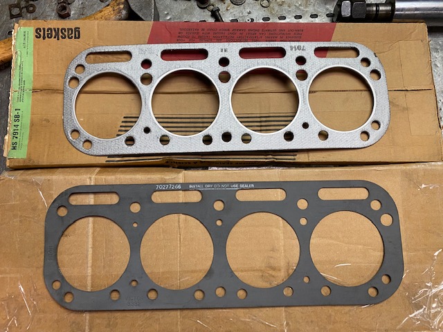

On first rebuild, we used the head gasket supplied by Reliance with rebuild kit. Don't remember brand, but it had a fire ring. Installed that using a spray on copper gasket sealer. Torqued down bolts, filled block with water and let it sit overnight. By next morning, had water dripping out of oil pan......so that head gasket failed.
Ordered a new one from local supplier, and when that showed up, it was a Victor 3332.....no fire ring. Meanwhile, found a NOS Fel-Pro with fire ring, installed that dry, as per instructions, and it held fine until recently when the valve failed and we took it down again.
Now need a new head gasket. We have the Victor 3332......no fire ring. In fact, two of them. One red.......one gray.
Does anyone know the number of the comparable Victor, with fire ring? And a source for it?

Date Posted: 20 Dec 2022 at 2:33pm
Time for an update. As has been noted in this thread, there appears to be two valid NOS gasket numbers. One is a Victor 3145. I was mistaken thinking what we had put on was a Fel-Pro. It was the 3145 and it fit and worked well.
Second valid number appears to be Fel-Pro 7914. Both Victor and Fel-Pro gaskets heavy built and both have fire rings.
BUT.....they are not the same. Hole patterns are different. Hoping somebody can explain why.
So here are the two hole patterns:
Gasket on left is actually a Victor 3332 (no fire rings) but is same hole pattern as 3145. Gasket on right is the 7914. Note on upper right corner is an extra hole. Not only that, but the three holes for coolant are different sizes on the Victor (and almost all others) but are large and same size on Fel-Pro 7914.
So on the extra hole, there is no corresponding hole in the block, but there is in the head. Why is that?
And on the variable sized coolant holes, the holes in the head and block are all the same size (same as Fel-Pro 7914, but on Victor gasket, they are three different sizes? Why is that? One theory is holes get larger from front to back.....so small hole closest to water pump allows limited flow, getting larger as you move aft.....doing so means coolant water is forced to back of engine vs. taking first exit it comes to (first large hole to front of engine). As noted on photos below, holes in both block and head are large, holes in gasket smaller and restrictive.  No clue why.
Given all this, which gasket is MOST correct?
Posted By: DrAllis
Date Posted: 20 Dec 2022 at 6:09pm
Why does the gasket on the left look to be an inch or more LONGER than the gasket on the right ?????????
Posted By: modirt
Date Posted: 20 Dec 2022 at 7:10pm
Must be an optical illusion. When placed one on top of the other, same size. Differ only in hole patterns.
Picture of gasket on Reliance website, similar to the one on the right (Fel-Pro). Most others on Amazon, ebay, etc are like Victor, with small holes, missing hole.
Still trying to understand why the head has a hole, but block doesn't. One gasket blocks it off at the head (Victor), the Fel-Pro put a hole in gasket, but that is a dead end, going only as far as thickness of gasket.
But apparently both work. Just strange to see them side by side like that and have them different.
Posted By: MACK
Date Posted: 20 Dec 2022 at 8:18pm
Have saw it a lot of times, one has a hole and the other don't.
I would use gasket on left and make firerings.               MACK
