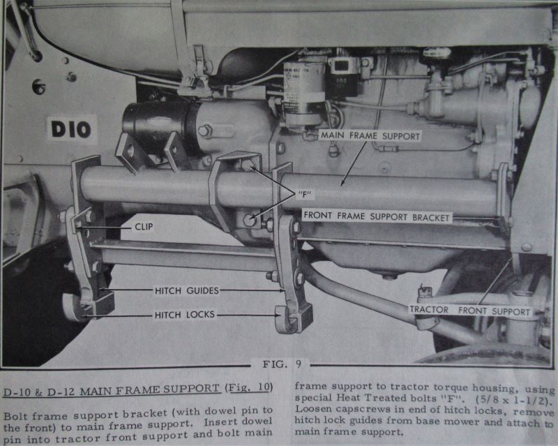

Dusty my 82S manual shows it mounted to a D10, D12, D14,D15,D17, 190, WD, WD45

Fitting it to a D-10 or D-12 requires that an extra piece  be installed to take the place of a frame rail.
If I had one on a D-10 or D-12, I think I would be putting a counter weight on the LH side for more stability.
As a matter of fact I have even thought of doing this to my WD-45 because I mow some pretty steep side hills.
