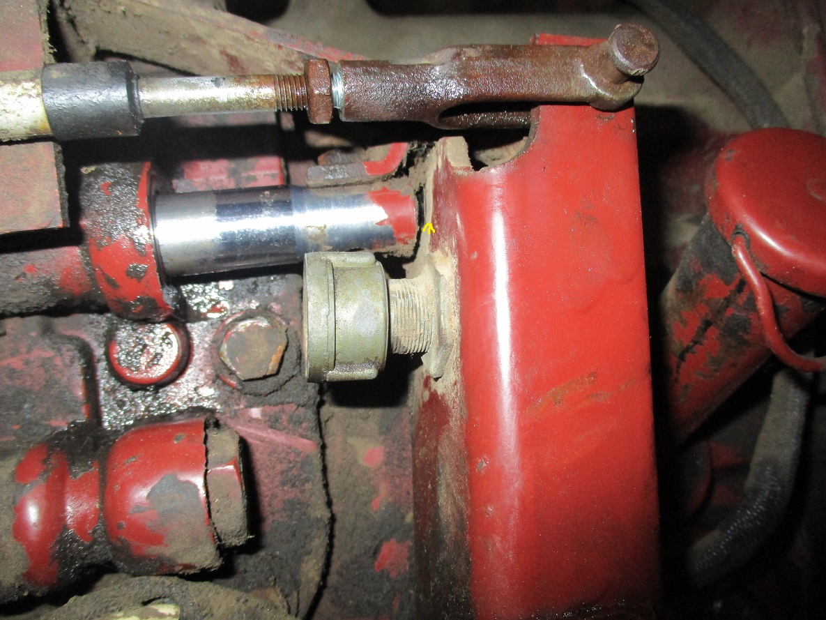

I took the clevis off, and found the lever moves fine, no binding.  The cotter pin holding the clevis pin on has been changed, and was mangled. So I tried adjusting the cable some. Nothing changed. Still sounds like buzz saw cutting steel about 3/4 of the way, but quiet at the end. I hitched the 7000 to the mower, and found I would need shorten the drive shaft about 6". Then hitched the Zetor to the mower and found it comes 8" from the pto. I have not cut it yet. I need to do some measuring to make sure it will work on both tractors. In the picture by the little yellow mark. The plunger is supposed to have up to .020 clearance, not about 1/8". But it made no difference tightening up the clearance.

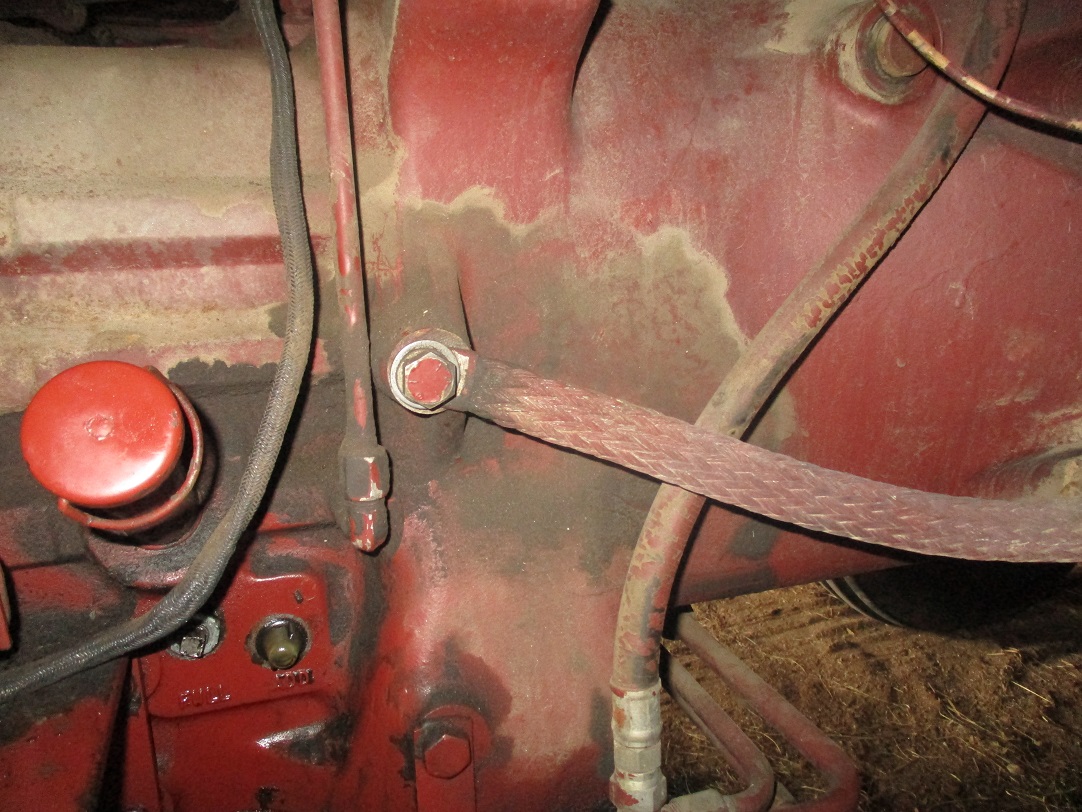

Finally I got a chance to look at the 7000 that's nearby. But first I want to start with a couple days ago. My son is in the cab, and I watch him slowly bring pto in all the way. The pto turns slow, then almost stops, then spinning. But then I'm hearing bad bearing sound coming from the pto shaft at the back of the tractor.  So I walk around and tell him I'm going to the valve body for the pto. He tells me he can here that racket upon engagement, then quiet. So he engages the the pto, and I can hear that hydraulic squealing sound coming from the pto valve body. So instantly I'm thinking there's something gone bad in there. But then in the next second I'm hearing a bearing that is chucking bad, and does not sound good at all. So the sound is just traveling down the shaft. I'm thinking the squealing sound is the hydraulic oil going by the spool valve, has it tries to turn the shaft. The bearing is that bad. The other tractor makes absolutely no noise  with pto engaged. In the picture the bad bearing sound is coming from the area where the neg battery bolts on.

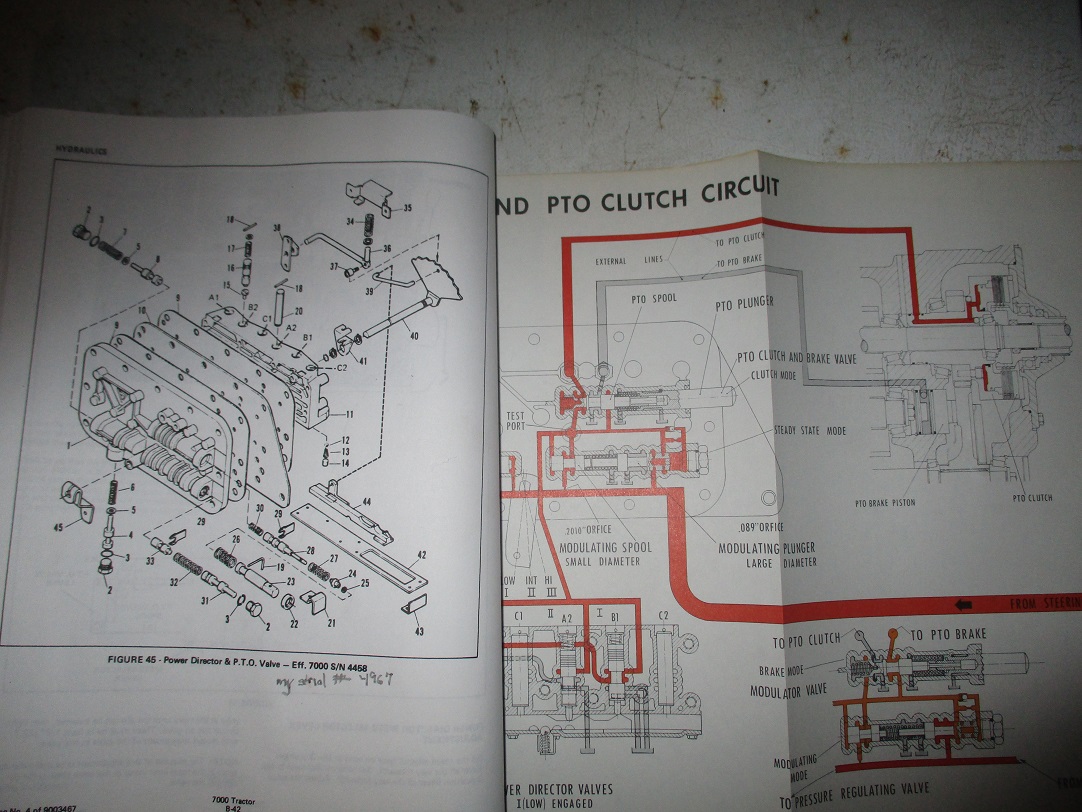

we have several 7000 's with high hours.  We are finding the aluminum valve body is being deformed where the steel spools slide all the time.  You may or may not have an issue as tractors are like motherinlaws  no two are exactly alike. I would pull the modulator valve out and check to see if the bore is perfect and not sticking the valve. If it has a ridge on it polish it out...  That is the valve removed below the inching valve.
Posted By: Tim NH
Date Posted: 19 Jul 2021 at 10:23am
Thanks Tim for your reply. I do want to take the outer part of the valve body off. After looking in my manuals. Only a bunch of oil should come out, not other parts.
Posted By: MACK
Date Posted: 19 Jul 2021 at 9:23pm
#29 and 33 will fall out. Make sure they go back in right places. They do crazy things if lost or in wrong places.                MACK

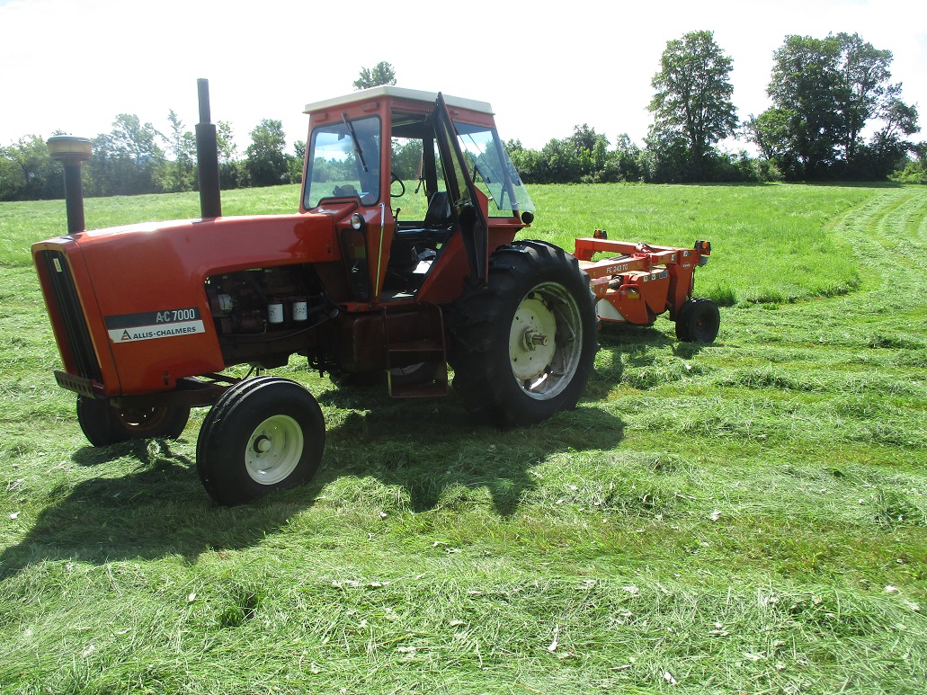

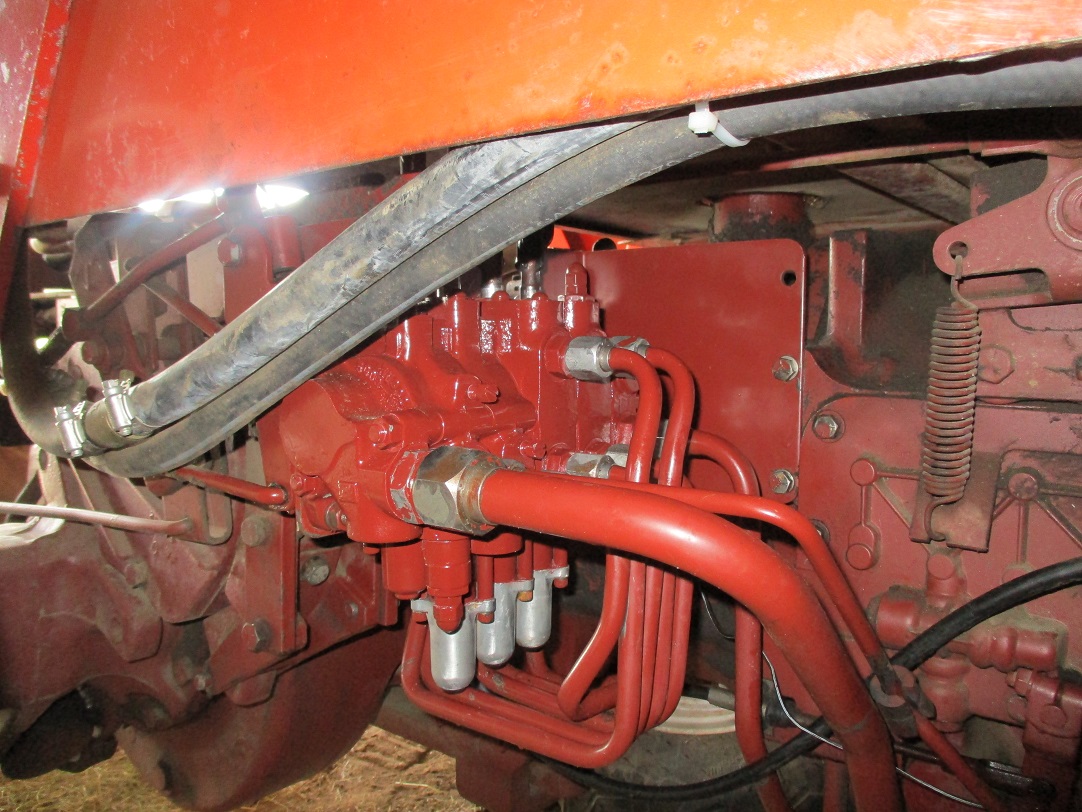

I got the new pto shaft installed, and mowed with it today. It does start the mower slowly, then comes right in. I'll run it like this till fall. Also the valve bank leaked so bad I had to change rags under it every time I used it for raking. I fixed that over the winter. When I was done mowing I felt around the valve bank, and it was dry as a cork leg, lol. It was such a joy to mow with a two wheel drive tractor again. And then not have to unhitch from it.

Looks like the day she rolled out of the factory.  Very nice.  I spent many hours planting with a 7000 and a  8 row 30 in 5100 white planter.
Posted By: Rltool
Date Posted: 29 Jul 2021 at 8:42pm
That looks like a picture post card.
Beautiful set up.
Good work Tim! Staying with it & figuring out a problem payed off.
Ray W.
Posted By: Red Bank
Date Posted: 29 Jul 2021 at 8:58pm
Beautiful picture. I have the same mower
