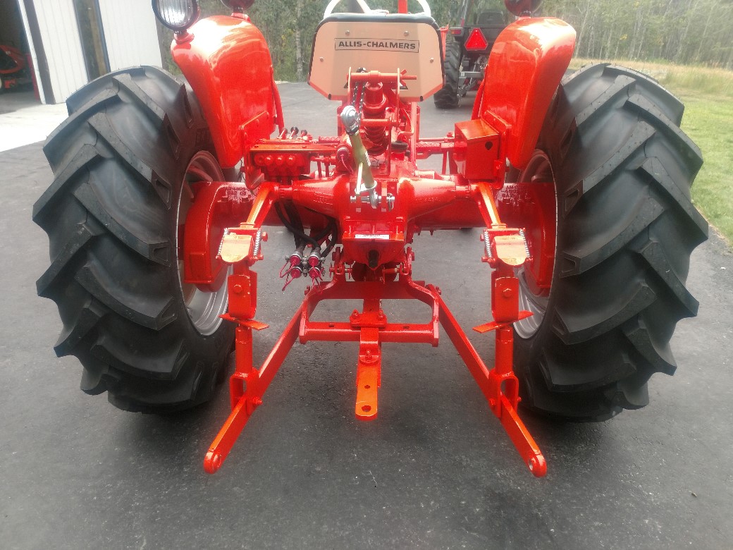

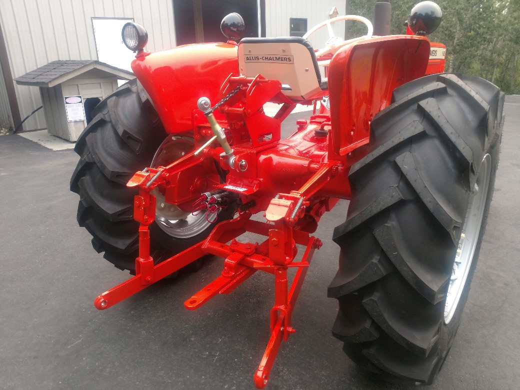

Posted By: modirt
Date Posted: 01 Jun 2019 at 9:46am
About a year ago, I found a "derelict" D15 Series II hiding out in the barn across the road from my house. Owner said if I could get it running, I could have it. I got it running......but found a host of other issues that were all eventually resolved. Your problems with running does sound like a fuel delivery or ignition issues. Frustrating, but likely as not will be an easy fix once you trace it down.
On the SC hitch.......I had major issues with the factory 3 point system and eventually converted back to a snap coupler.......sorta. I installed this 3 point conversion kit onto it and it, which in my mind is the best of both worlds. Uses standard Cat I 3 point hitch implements or drawbar without need to remove anything, and the SC hitch setup is stronger than the factory 3 point.
This 3 point conversion kit is made by Cross Manufacturing and is available from several sources......
Not that I've got it running and have put it into use, it is a handy helper around here. Currently being used to rake and tedder hay.

Posted By: C-Reid-Mac
Date Posted: 01 Jun 2019 at 4:27pm
Thanks, Modirt. Especially for the pictures.
